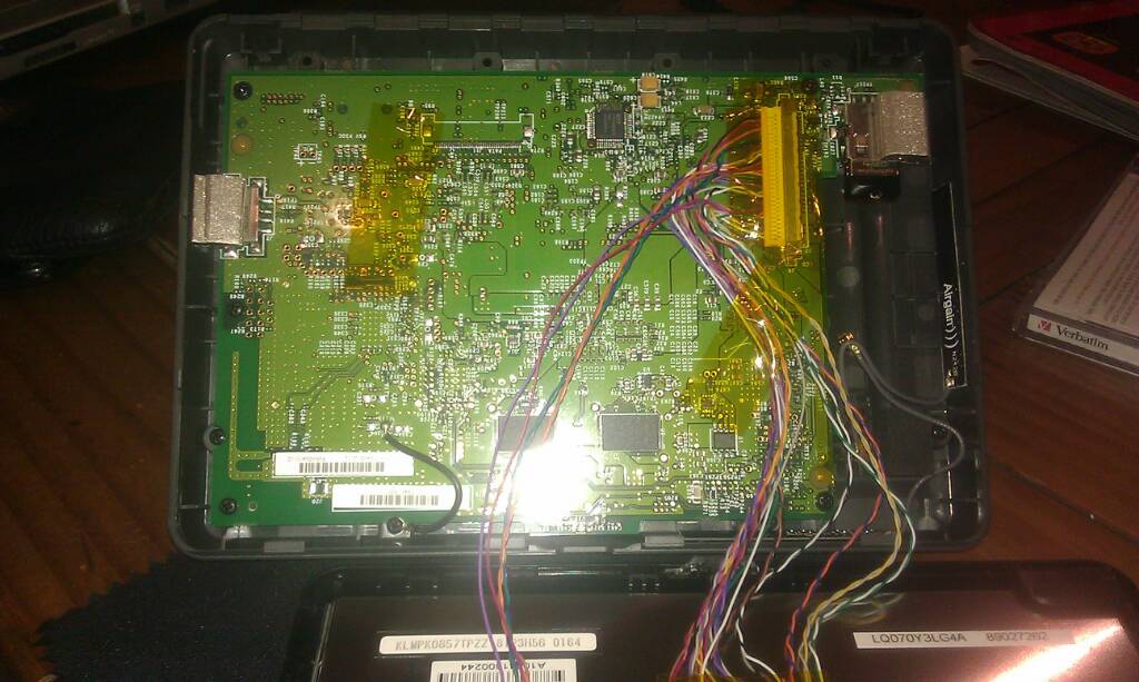

The wifi card goes in a USB port internally, so if you remove the card you can boot off a stick inserted there. I have a joggler running permanently off this port. Providing of course nothing has been damaged with possible shorting of the external port.
You can see the card and port at the top of this photo.

Re: How much damage have I done to my joggler
And this is with a really small USB stick in its place
