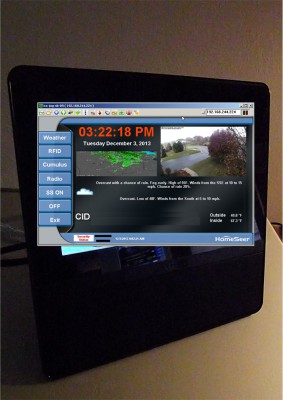

Here is one Joggler 2. I keep the screens really basic and just put different functions on each one.
This is booting off of an SSD ZIF drive connected to the USB port on the back of this device.
This one is XP. Its running a small little program (or agent) which talks to the mothership. It provides me with the remote stuff. Only thing is; is that standby works but WOL doesn't.

I think you are right! It could be too many reflashes. I have done it one more time and will just see how it goes. It has been going since the inception of UNR and has been very useful. The model you have adapted looks supreme! I am getting a spare to take a dip into the internal mods you describe and hopefully I could attempt something similar. the SSDs are quite expensive. I am presuming that it wont work off a mini sata? I am intending to couple a new one with a "500 Watt 2 Channel Car Audio Power Amplifier Amp YL2

The above pictured one is the most difficult Joggler to open. Originally a special tool was used that would push on 4 little clips that held the LCD in place.
Think is that the special tool went into the bottom of the case and past were the speakers were. I sort of guessed taking about the case using a thin screwdriver and a plastic credit card pulling up on the LCD.
