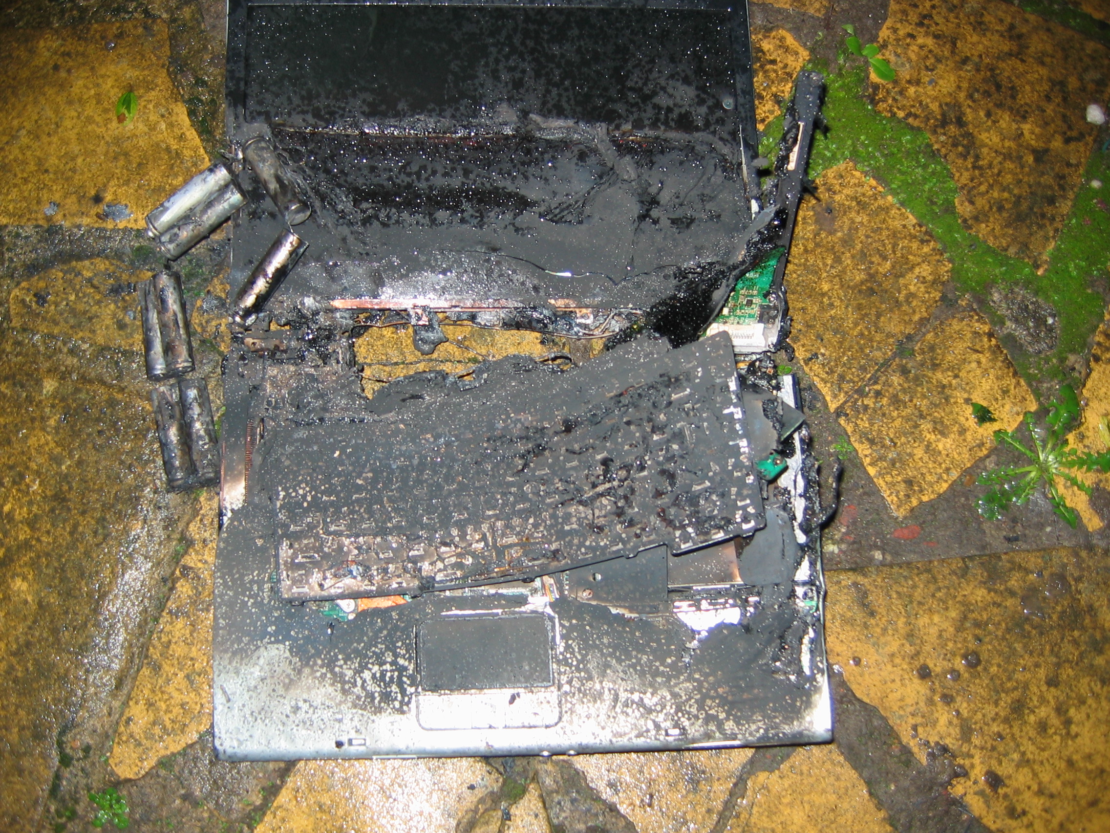

My laptop battery exploded today. Luckily I had just moved away from the machine when it happened. After evacuating my family (partner and 3 year old daughter) out of the house that was being filled with noxious fumes, I managed to get the laptop out of the house into the lean-to. It continued to burn vigorously until the fire brigade came round to put it out.
Luckily no-one was hurt. The laptop is a right off of course.
Had I been using the machine on my lap, or even sat in front of it, I may have had some serious burns. Had I not been at home, it could have burnt the house down. I'm very relieved that the outcome was that no-one was hurt, and the only damage is to the laptop and table it was sat on.
See attached a photo of the machine taken after it had been put out, and my house was safe to enter again (Fire Brigade used a fan to clear the house of fumes and smoke).

Thanks for the kind comments. The fact that no-one was hurt is of course the most important thing. To answer some questions:
Q: What make of lappy was it? Was it the original battery?
It was an acer travelmate 8104wmli with original battery and charger. the battery was old, as is the laptop, bought new in 2005/2006. The battery was virtually dead in capacity, and gave about 15 mins of use. Due to the design of the laptop, it sat better on the desk with the battery in imho, so I left it in. In hindsight that was a mistake. However you don't expect them to fail like this. I did stick my multimeter on the PSU which is still working fine. Infact when the battery starting pushing out jets of smoke, the laptop was still running for some seconds. I'm mostly lucky I managed to get it outside before it was engulfed in flames.
Q: Any idea of the type of battery and what caused this? Are you sure this is not arson??
Original battery supplied with the laptop (Li-ion afaik). I have since read on the net there was an acer battery recall in 2006/2007 but only in the US. Looks like mine wasn't safe either! No Arson, I mean, I was stood in the room with the thing when my missus shouted out to me, and I saw it going up in flames! after evacuating my kid and missus out the front, I held my breath (the fumes were choking), and went back it and managed to throw the laptop into the leanto (concrete floor). I then went back outside to check on everyone and have a good cough (I can't tell you how bad the fumes were!). I then went back in, and the laptop was engulfed in flames. At that point, due to the choking fumes, I called the fire service, who went in with masks etc, and put it out.
the big problem was when it went, it was like some pressure hose, with smoke /flames shooting out the thing under pressure, from the back/top (which was melting and catching fire) and out the sides (as I remember it).. the fumes were completely overwhelming. I wasn't actually able to stay in the room to say fill a bucket with water. I also wasn't sure that putting water on it was a good idea (lithium + water etc). I'm very lucky I managed to grab it to get it out of the house into the lean to before it went up completely.

Re: laptop battery explosion
A friend linked this to me earlier after hearing my news:
it was quite similar in my case, except the time between smoking and exploding was much shorter, and the initial explosion more violent, perhaps due to more cells going off, or the design with a large battery covering most of the back of the machine.
Another similarity was the delay between the last "explosion" in the video and the machine being on actual fire. I guess I got lucky, as when I stuck the machine out the back door, it wasn't fully in flames, but after being explosive. And my machine went up in flames moments later, albeit more than in this video.
So I got lucky with my timing, that it didnt burst into flames or explode while I was moving it (I realise now, it could easily have done so, was a lucky night in all considering all the possible outcomes).
