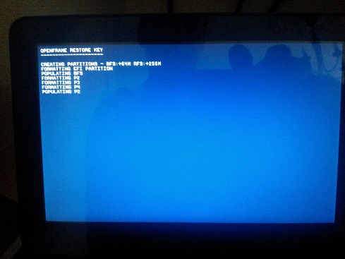

Thanks for this - I just dived in and tried it:
Flashing...
Flashed...
