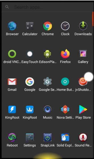

Done here modifying. Initially and most important is to root the device.

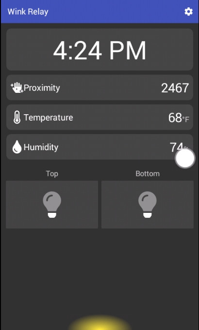

Here is the base / main screen I am using which speaks MQTT such that you can remote control it and read the temperatures on it.
