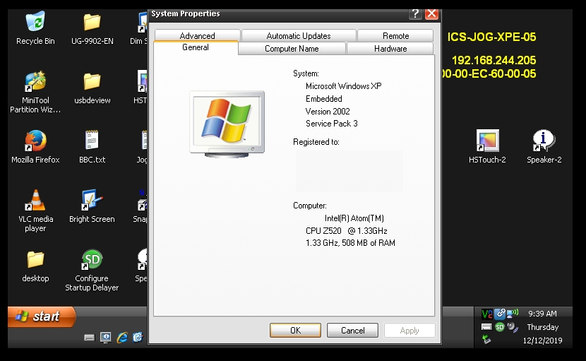

Here is a VNC snapshot of one of the boxes. Runs fine with 512Mb of RAM and using SSD drive.
Windows 8.1 embedded and Windows 10 works but is too slow. Working on W7 embedded...having issues with drivers though. Windows 7 lite works.
I have 15 of these running today XPe and used for automation touchscreens. They all run agents today for remote control by the mothership. I have one booting to Linux using EFI bios with the 16Gb SSD. The O2's here are only used for Squeezeplayers mostly today (have 4 running now for some 3-4 years).
