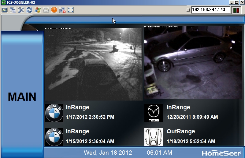

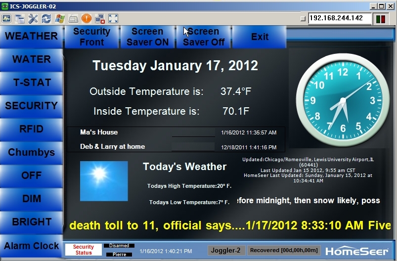

I use automation software called Homeseer (over 10 years now). Kind of pushing it a bit with 14 touchscreens each with 30 "pages" of variables. Works OK with the Joggler. I'm no artist so my pages are more functional than aesthetically pleasing.

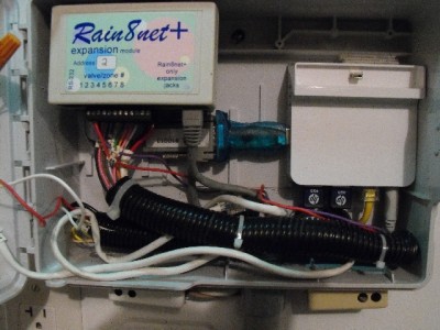

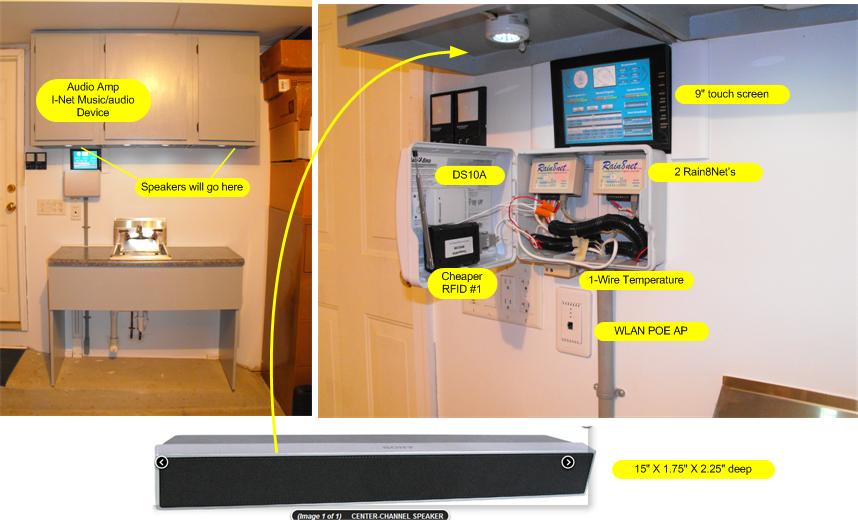

A new project which is loosely part of the above project utilized XAP for HA transport on your network. You can create flash based automation screens with variables based on XAP. This works too. You can have HA "appliances" receiving and sending HA XAP commands to a touchscreen. I'm playing with the Seagate Dockstar (sheevaplug) doing similiar. One project completed and will be utilized next season is my sprinkler system. It is connected hardware wise to two Rain8Net zone controlllers. The Sheevaplug (seagate dockstar) is getting live weather data (from Davis weather instrument) via XAP. It is running ArchLinux (and the other run is running Debian Linux). You could run the application on the Joggler and have an "all in one" setup with the touchscreen and the controller.
The pictures below are in my garage. First picture is first gen with the TS application running connected to the "mothership". Second picture is of the seagate dockstar inside of the sprinkler box; being the only control now (appliance like) of the sprinkler system. Next step would be to just install everything on the Joggler and utilize the Joggler for the controller (combo touchscreen, application and hardware control). You could then run the streaming audio, video (security), sprinkler automation and have a touchscreen as an "all in one" configuration with a smaller footprint just using the Joggler versus a separate touchscreen and Seagate dockstar (sheevaplug).
There are RFID "tags" (cheaper RFID reference) in the automobiles which trigger events when they are in the vicinity.

Something like 800 variables (which always change) and about 200 events / scripts running on the "mothership" and another ~ 50 events running on the alarm panel. So the touch screens can show any of the variables or run any of the events.
The mothership today controls the Jogglers displays (dim, bright, screensaver or what screen is displayed or just shutting them off remotely).

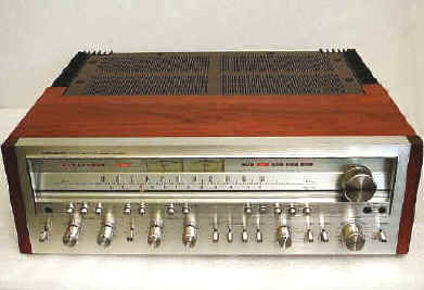

I did own a Pioneer SX-1280 at one time. It weighed a bunch and it was large. Some car sales shop wanted it for his dealership; wanted "big" I guess and paid for the shipping of the receiver cross country freight. The receiver did blow the horn tweeters on the Altec Lansing Stonehenge III's a few times. Altec Lansing had a refit kit and it was easy to replace the pieces to the horn tweeters. I remember sometime back then having a Thorens platter with an audio technica needle (geez I remember cleaning/wiping my record albums for like 10 minutes before I would play them for fear I would damage either the record album or needle). Big thing with the Bose 901's was using the resonance ports to blow out a candle. One of my favorite speakers was the Klipch Heresy's. Very well built speakers. Today the MM room has a hodgepodge of speakers for the 7.1 sound. JBL mini towers in the front and a bose center speaker, Polk audio in ceiling speakers for the side back and Russound rear externally mounted speakers. Plain and simple. I do recall the very old JBL studio monitor speakers I used to have; they were much nicer back then than todays JBL's. I still have an old stacked Akai reel to reel with all day radio recordings from the 1960's that I kept. Its still in the box stored; but most likely the drive belts are shot. I did just have an old Marantz SD9000 rebuilt; not that I use it; but always liked its look. I still also have an old Nakamichi Dragon; haven't checked to see if that's still working though.
