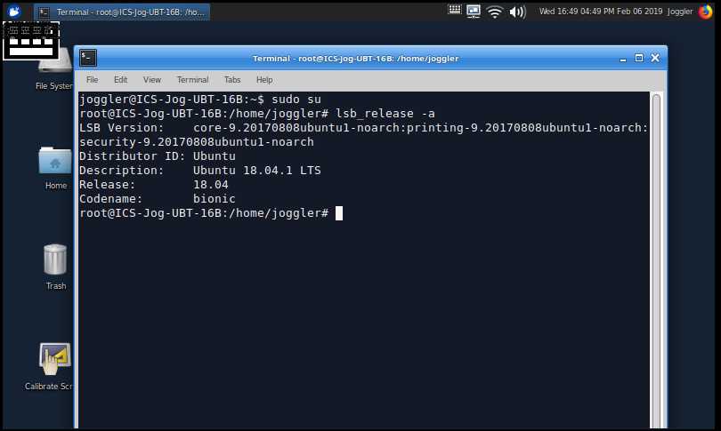

I think there is enough space but anyway have expanded the partition using gparted.
I put the stick back into a hub connected to the joggler and restarted.
Got a desktop and was able to log on.
The touchscreen works but I could not use it in a terminal (I have installed florence).
I have tried a terminal on the jogger with
and get the same message as above.Code: Select all
sudo apt-get -f install
The web browser does not work, I get an Error message saying that it is an invalid file entry.
