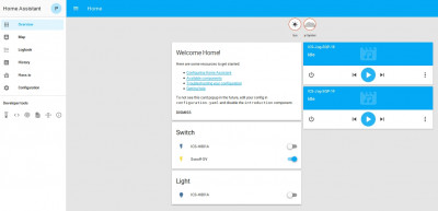

Re: Mosquitto - MQTT
Installed HA yesterday and it automagically saw my Squeezebox server and Joggler players (have more than two running today).

I don’t think HASS LMS tool does full auto discovery like LMS player so my guess is that it found it on port 9000 on one of the HASS known servers ... perhaps on same system as HASS itself.

Yeah just starting to play with HA here.
Mostly utilize Homeseer for Automation (well now some 20 years). Installed a Mosquitto plugin to Homeseer.
Homeseer currently speaks X10, Insteon, UPB, Zigbee, Wifi, Mosquitto and ZWave.
That said now tinkering with WiFi devices upgrading them with Tasmota or ESP Easy firmware which talks Mosquitto and to HA built in.
Installed HA it on a separate box running Ubuntu 18.04 64 bit (overkill spare shuttle netop computer) along with Node Red.
The Squeezebox server is running on the MythTV box here and getting it's music from a configured NAS.
Have 3 NAS boxes here. 2 are 5 drive older NAS boxes with propietary embedded Linux and one is a FreeNAS (now XIGMA NAS) box with 8 drives in it.
I have a few Jogglers (powered on demand) connected main Squeezebox server.
The above HA stuff just came up by itself before installation of any plugins so then it must see the currently running Squeezebox server and two Jogglers running Squeezeplayer that were on.
