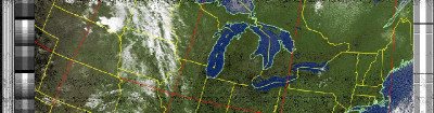

Here have an SDR USB connected to a RPI in the attic that has been working grabbing NOAA satellite pictures now for a about a year.
Testing with two antennas in the attic.
