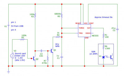

So I bought an el-cheapo "Dynamode 7.1" USB sound card as suggested - which has 2 LEDs. Like the MP3+ I mentioned earlier, the green one flashes when SQplay is running, and is on constantly when it stops. I devised the circuit below to provide a drive to an SSR I had lying around which I inserted in line with the AMP. I migrated to PNP3 so I can stop/start SQplay on demand (which controls the LED), and also via my home automation system (SSH command to run trigger.cgi - same as using the GUI). So I still have local + remote control, but only the joggler 24x7 is on 24x7. The circuit looks like this:
I took out the 2 coupling components to the now unused input jack, and used that jack as the output to the SSR which makes things a whole lot neater. The SSR in my case is a 3-15V OACM-U from Tyco/Potter & Brumfield - there are many similar out there.
Photo of the hacked USB sound card below (sadly I didn't mange to make the board small enough to fully reassemble the interface!), and the innards - enough space to put my little circuit inside. As an aside, in another life, I might have done this with a simple comparator / op-amp if I'd remembered how picky the 555 is about retriggering ! Anyway, it works.

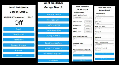

Here currently utilizing many of the Jogglers as touchscreens for automation server. Most of them are running embedded XP but can do similiar with Ubuntu and Android. Automation here using X10, UPB, Zigbee and ZWave and most recently testing SonOff WiFi basic modules using Mosquitto (wave of the future) internal to network.
IE: modded basic $5 USD Sonoff (arduino) with Tasmota firmware using GPIO pins. Firmware is updatable via OTA or JTAG - 1 Mb flash.
Functions using Mosquitto as:
1 - Button GPIO A - high or low voltage relay switch
2 - GPIO B - one temperature sensor
3 - GPIO C - door sensor 1
4 - GPIO D - door sensor 2
5 - GPIO E - tiny PIR sensor
This now and playing much with Node Red. You can make the Joggler an automation server running Linux and utilize a browser interface. Graphics though are a bit slow.

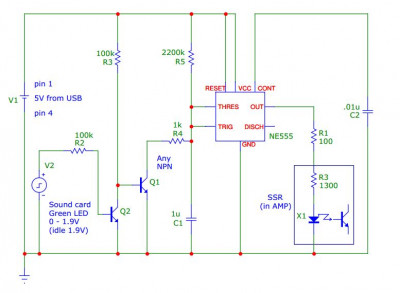

After using Pete's scheme to get Wake-on-LAN working, I found that the power-down scenario forces the AMP on all the time (USB 5V remains present, no way as yet to disable). Not so useful! Also during bootup, the USB LED gets toggled a few times. So a longer timeout to mask some toggles, and AC-couple the input to ignore steady state. Here it is
Revised AMP interface
