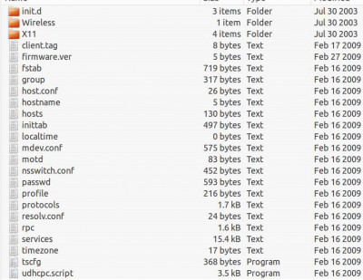

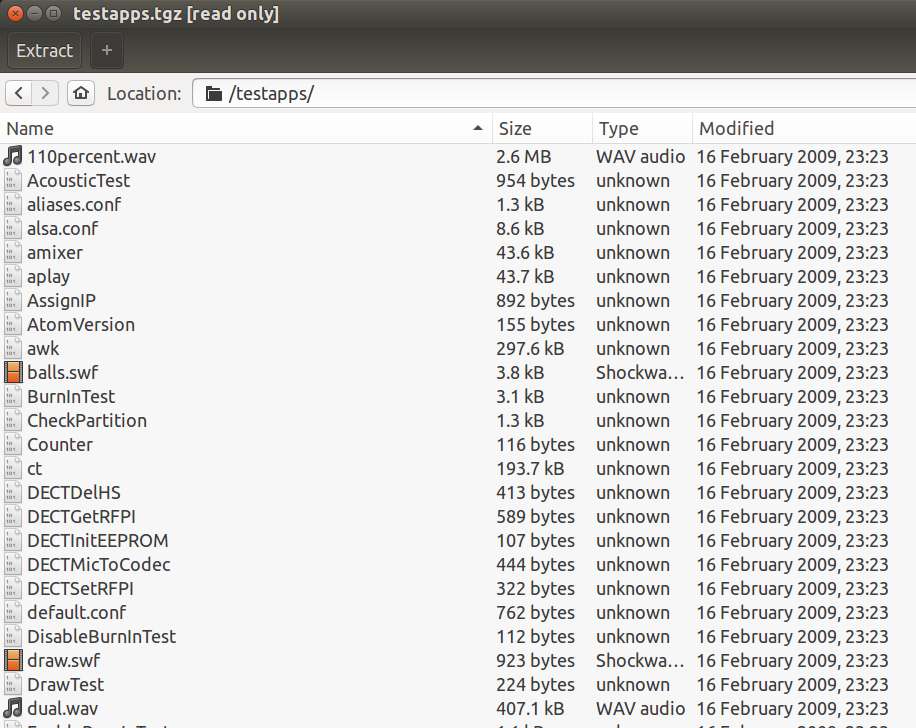

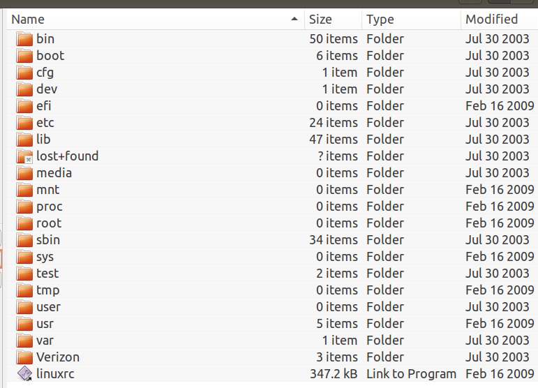

With a little bit of tinkering you could maybe get the image to boot from a USB stick. Thinking though it's been written here that it will not boot.
That said here wrote the image and went exploring...as mentioned previously it will be easy to modify the boot to go to a command line prompt and nothing else.
You have been playing with xorg. Look in the init.d for it to boot the xwindows stuff.
Then have a look at the attached image directories. Look at the test directory for DECT stuff. I am guessing that the Cisco image has zigbee testing stuff on it.
The OP2 was the deluxe version of the Openpeak devices. Take yours apart and check out the motherboard.
