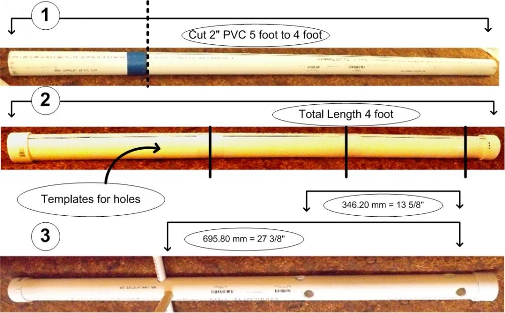

Started project with a V-Dipole antenna (below picture) which is highly directional and does work.
The V-Dipole antenna is around 21" and looks like a TV antenna in a horizontal plane. It is small.
The antenna below is omnidirectional and a bit larger at 4 feet high.

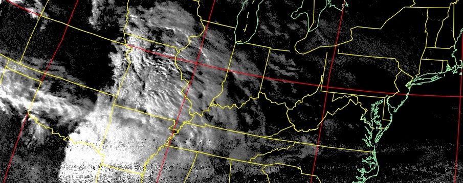

Base Software
1 - 3 bash scripts
2 - OS can be Jessie, Stretch or Ubuntu
Basically the bash scripts create a schedule when the NOAA weather satellites pass overhead and then captures the pictures sort of like a fax machine line by line via sound. If you listen to the satellite it sounds a bit like a clock with tones.
