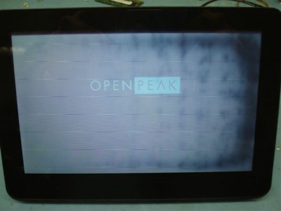

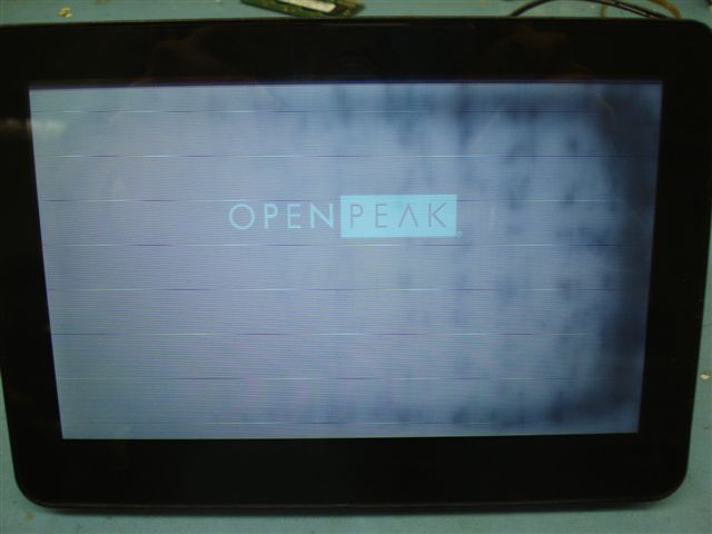

Hi guys,
I'm getting some screen corruption on bootup on the original OS. I've flashed it back to factory, but its still there. Strangely, the screen is fine once its booted the OS to the O2 splash screen.
Any ideas...? Slightly confused here!
Cheers,
Dave

One of my joggler's was booted up into linux. rebooted to try a newly build grub, and the screen corrupted. thought it was the gop video stuff in the newer grub, and tried a few more times. no luck. put the old stick back in and realised the joggler is not working :(
Boots from usb, and either freezes, or the whole screen corrupts badly and it crashes. I'm now wondering whether it has just failed at the same point i was doing stuff, or if the new grub did something bad with the hardware/efi for example. next ill have to try sticking the efi chip from my other joggler in it, but not what i wanted. grumble.

Re: Screen corruption on boot, original OS
Good news! Joggler repaired. I hot swapped the faulty joggler's EFI chip in my working joggler, rewrote it from an image I had dumped previously, and all is good, so the EFI was corrupted as I suspected. Still slightly worrying "how" it happened. Was it grub probing something causing it, or just a random bit of bad luck.
