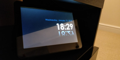

The new clock interface (unlike the old OS it had to be accessed from the screensaver instead of tapping the top right small clock) is smaller and harder to see. In fact, from a distance the date's thin blue text cannot be seen at all. Just the time, so of course the residents of the house aren't too impressed.

Current clockface. Aim is to get similar readability as the original.
