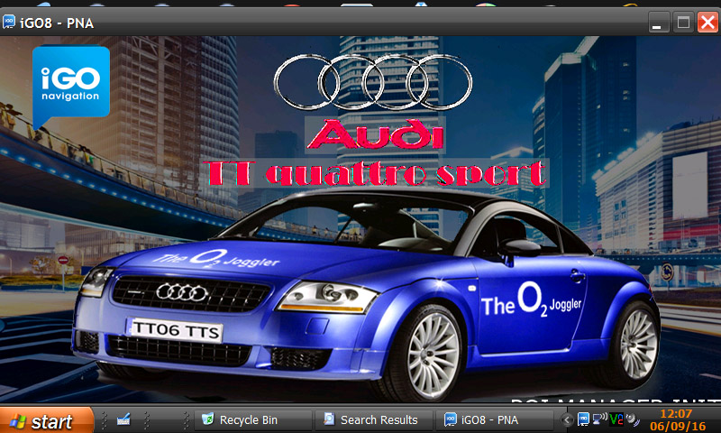

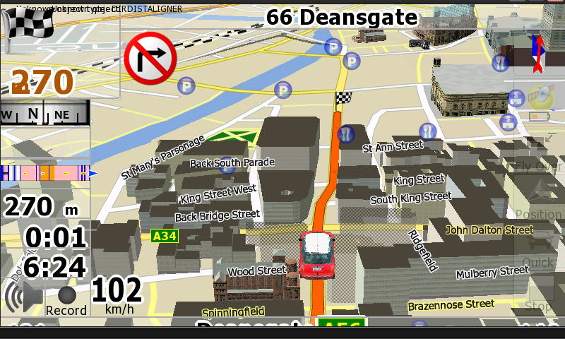

Finally got round to trying Sat Nav on the Joggler.
Used Mevi's XP as the base and iGO 8.3.1 PC navigation software.
At the moment just testing with a USB GPS dongle plugged into a four port hub
Short youtube clip
https://youtu.be/NGnNQVdk-e8
Short youtube clip

Couldn't find an Audi TT in blue so just left this one on it.
It's much better than Garmin Mobile PC and runs very smoothly on XP.

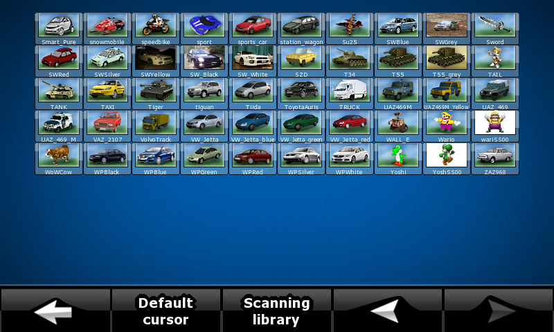

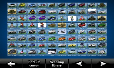

Now got 3Dcars working & the app completely fills the joggler screen.

Downloaded a few utilities for IGo.
Trying to change boot theme and noticed I cannot read the BMP files.
I have attached one of the utilities I found. There are a bunch out there.

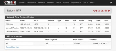

I also have a newer test tinkering GPS module in the attic that I use for my NTP server (does PPS too). This one has Bluetooth, USB and a serial port (well too it is programmable) for output at 4800/9600 and does a modified NMEA sentence. What is amazing about it is that the antenna is in the attic and it can get up to 15 GPS satellites.
