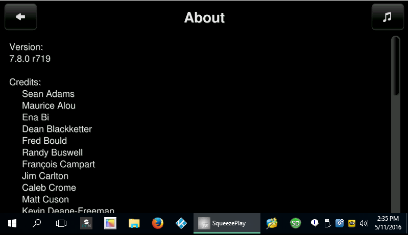

Trying new version 7.8.0.r719 right now.

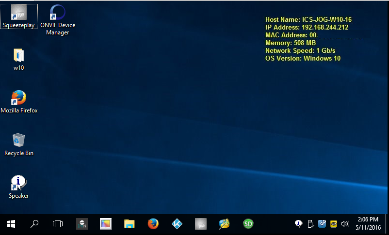

It runs fine also on the PipoX7 with Windows 10. I haven't changed much on the PipoX7 (running stock W10). I have changed a bunch on the Joggler running W10.
This is a on Windows 10 enterprise. It runs at the same speed here that the Ubuntu / Linux version runs.

Today will install new and old on the PipoX7 that is at Windows 10 that originally was updated from Windows 8.1.
I haven't really touched it much other than auto executing on start some applications.
KODI, SAPI, Kinect, Alexa application, HA Touch client, HA speaker client are all running fine. I have done a bit to it but not much and have tried to leave it mostly stock.
I think it is running the home version of Windows 10 where as the Joggler is running the enterprise version of Windows 10.
I was bit busy yesterday so tested today. Works fine except for the problems I mentioned above testing on the Joggler.

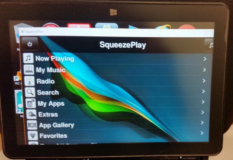

Did you ever get this working on the pipo x8, I have the same problem only in tablet mode. Works in desktop mode but the window doesn't go to the screen borders, I have to drag the window to the top left corner of the screen.
In tablet mode I get the same small icon, if you tap it in the right spot it will minimize and then if you the squeezeplay tile again it does open.
