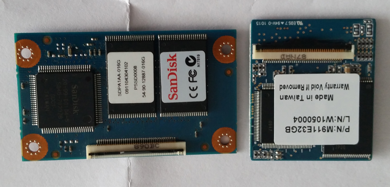

Just received the pata SSD from Korea, not as big as you thought Pete.
Re: Pata ssd drive to fit joggler
Very nice MickChip.
Here my issue with the mSATA ZIF card was the thickness of the board with the mSATA drive. Height and Width were fine. I fit it over the WLAN stick and the LCD clips in to place without pressing much on the LCD. The test Joggler today has an RTC/Battery (very thick) with the SSD ZIF over this device.
Looks like it should fit inside of the Joggler. I use a long 15-20cm flipped ZIF cable. I have not been able to find the blue / blue flipped cables which were the right thickness so went to blue/white flipped cables and put a piece of scotch tape on the white side to make the cable a bit thicker.
You can just do a 90 degree bend on the cable if you want to fit it inside of the Joggler over the Wireless stick. There are also 1.5" ZIF PATA SSD drives out there.
