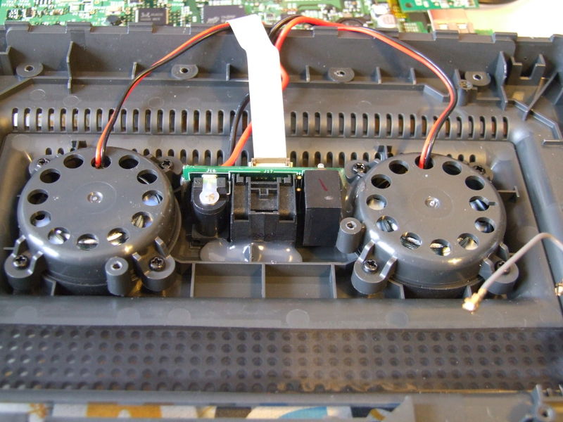

Mentioned above too is that the barrel connection board inside of the joggler is hot melt glued in place.
If it gets loose then the power plug doesn't connect or just connects when you push it in place then disconnects when you let go of it.
The easy fix here is to take apart your joggler including the motherboard. There is a ribbon cable connected to the board in question. The two power wires are separate. Look see if the board is loose and either heat up carefully the hot melt glue or use a glue gun and add more glue.

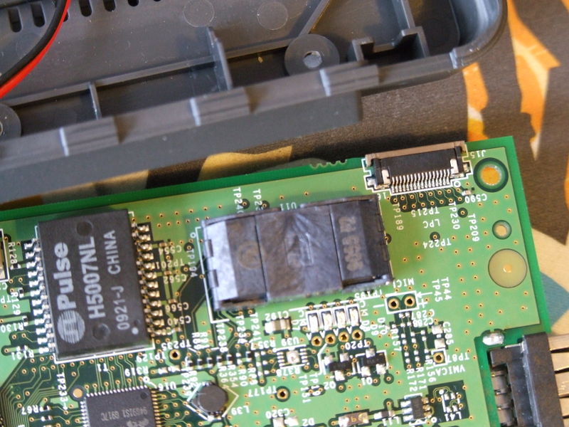

If you have the joggler apart have a look at leds next to the boot chip to see if they blink when you first power it on. This will show you that it is reading the boot chip. If the boot chip is trashed it might only blink once and not afterwards.
The boot chip / 4 LEDs are shown in this picture.
While you are there check out the board in this picture that is hot melt glued to the back of the joggler. I have fixed about 5 of these now that the board had moved inwards and making the power plug loosey goosey.
