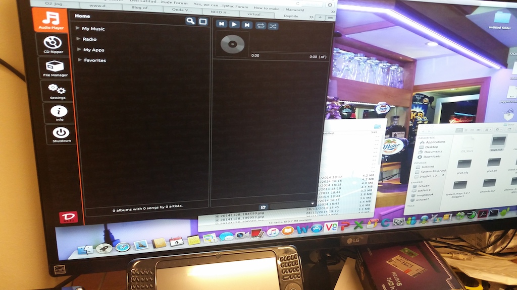

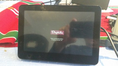

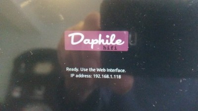

It starts to boot using coreboot fine changing the syslinux.cfg vga=786 or vga=normal.
It lets me configure everything. Then it goes to trash video or a kernel panic and doesn't start.

I did install it as a VM on another computer today. Looks a lot like Squeezeserver.
Might give it a go on the MythTV / Squeezebox Server computer.

I suddenly realized that it might be a misunderstanding when you say it appears to trash video.pete wrote:It starts to boot using coreboot fine changing the syslinux.cfg vga=786 or vga=normal.
because when the server starts to work, the screen will be shut off and need to access the server through Ipad or other mobile device with remote control app installed.
so maybe you can try to use some app such as "squeeze control" or "squeeze commander"on android or other squeeze app on apple to access the server.
