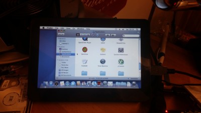

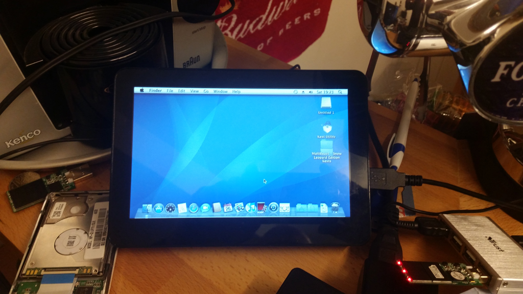

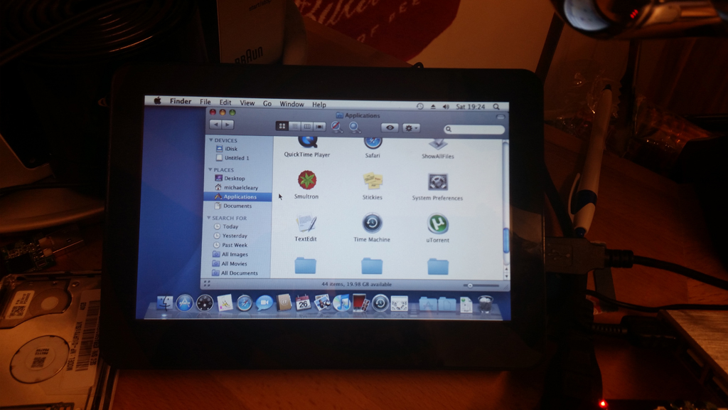

Just this minute got the Joggler to boot Snow Leopard
Screen res is 800x480 no wifi or Ethernet as yet but I will work on it.
Touch screen works but is out of alignment.
I am that excited I dare not switch it off, been trying to get this working for years.
PS it crashes if you click on "About This Mac"

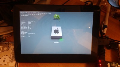

Here is a pic of the joggler boot screen, it does survive reboots.

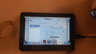

Another update, now have Ethernet & Wifi working

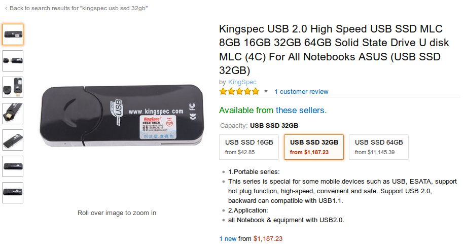

Found the Kingspec ones ones now Amazon, bit expensive though.
http://www.amazon.co.uk/s/ref=nb_sb_nos ... ec+usb+2.0
