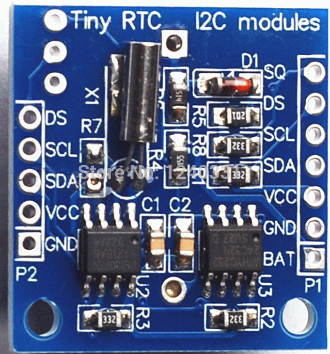

Can I connect a battery backed up RTC to the SCL/SDA pins on the ICS UMS9001 clock chip U13?
IE: Pin 5 is SDA (data) and pin 6 is SCL (clock)

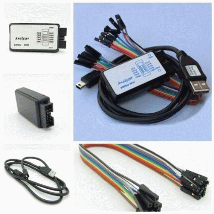

I bought a Saleae Logic Analyser clone very cheaply from AliExpress (around $10 delivered). The clones will work with the Saleae sofware up to a certain version, but it is also possible to use the latest Open Source SigRok analyser software with the clones as well. The analyser software should have a module that understands the i2c protocol.

Yup the only reason I was thinking of the RTC device pictured is that I used that one for a microrouter openwrt project doing a bit of bit banging and soldered a 1-wire temperature sensor to the RTC board.

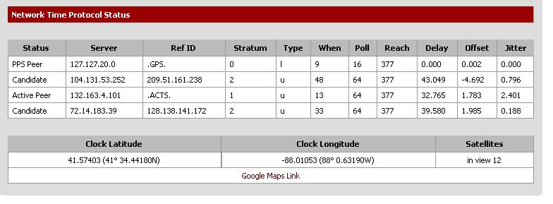

Here all of the clocks on the walls in the house use radio to sync time. They work OK though not great as here in Chicago I am getting time sync from Colorado. I do have a GPS with PPS connected to my PFSense Firewall and that works pretty good.

"Tiny RTC I2C Module" issue
https://forum.arduino.cc/index.php?topic=177297.0
are these yours ?
One of these talks to the RTC module via a terminal. Maybe it is possible to set up a terminal on the i2c bus ? There is some code in the above links to.
Will have a better read about the Tiny i2c RTC module later, I think...

are these yours ?
First link is.
I dunno yet and just ordered one for the Joggler on Amazon. They are more expensive there but I get them in 2 days.
I am testing blindly and guessing I will see a new value show up when I look at the i2c bus. Another way to do this is to purchase one of those mini USB with RTC devices. They are tiny and would also fit inside of the joggler.
Do you have a link to the logic analyzer. Is it from Seed Studio?

This is the original :
https://www.saleae.com/
but I bought a clone from AliExpress for less than $10. If your buying a clone you need to get some probes too, more then likely and there is quite a range to choose from.
You might like to have a look at this :
https://hallard.me/cheap-and-usefull-logic-analyzer/
should give you an idea of things.

Found this one for a bit more at $16.

Post by Juggler » Tue Jan 19, 2016 4:27 am
Yep thats the kind.
Did a search on ali and found this for $5 :
http://www.aliexpress.com/item/1sets-Ne ... 89296.html
You need some probes/test clips to go with this. How about 10 for $1 :
http://www.aliexpress.com/item/10pcs-Te ... 90956.html
So then your good to go for $6 all in !
All you need is the Saleae logic 1.1.15 (I think this is the latest version that will work with clones) software or SigRok.
You can even install on a Joggler.
Gee they just get cheaper...
