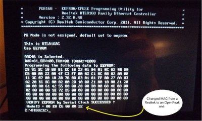

Found a program to write a MAC address to the Joggler, Openpeak or Openpeak 2.
This fix has been tested with the O2 Joggler, Openpeak 1 and 2 devices.
One will be labelled openframe and the other joggler.
Looks to be working with Windows 10.
Will post and detail program, bin and mac stuff.
It is very simple and sees chipset, ids it as a realtek then writes to eprom. Changed mac from Realtek to Openpeak testing a bit.
Tested doing a cold boot in XPe / W10 and it boots fine now with the new mac address and it does see the Realtek NIC Gb fine with no errors.
Note this has to be with a DOS boot disk in Seabios mode.
Did a few more last night. Works great.
Here is the link for the software and boot image.

Re: Writing a MAC address to Joggler NIC
Testing today 10th of January, 2016 writing to the NIC with an EFI booting Ubuntu build on my Openpeak.
Base is running latest Buzz's Ubuntu build on the ZIF PATA port.
Basically just loading up seabios rom, booting up with USB DOS stick with new NIC rom, writing rom, validating ROM mac address, then writing back the EFI boot ROM to the Joggler.
Note: a bit of caution here. If you fat finger this then you will brick your joggler. You can though do a hot swap of the EFI boot rom to fix this and rewrite the old rom to the new one while the Joggler is on.
0 - WRITE USB image to a USB stick. It is a combination boot to DOS stick and has the original ROM and SEABIOS ROM on it.
1 - put coreboot.rom (SeaBIOS (version 1.7.0) on a USB stick
2 - SSH to Ubuntu Joggler
3 - find where the USB stick mounted. (here it was under media).
4 - do an LS to make sure the coreboot.rom file is there
5 - modprobe fh
6 - backup original ROM
7 - dd if=/dev/fh of=joggler.rom bs=1024k
8 - do an LS to make sure that the rom image is on the USB stick.
9 - write the seabios rom to the joggler
10 - dd if=coreboot.rom of=/dev/fh count=1 bs=1024k
11 - reboot
12 - you should see the SeaBios boot now with two F key functions. One F7 and F16 (which is F12).
13 - F7 will let you restore the old EFI original ROM. The name it is looking for is upgrade.rom. Rename the Joggler rom you saved earlier to upgrade.rom
14 - F12 (F16) lets you pick what media you want to boot from. In this case we want to boot up from the DOS boot up stick with the eprom NIC writing software.
15 - boot to USB stick using the F12 function key. You will see it and once booted up you will be at a C prompt.
16 - do a dir and you will see a joggler and openfram directory.
17 - go to the appropriate directory for you device.
18 - IE: cd c:\openfram ==> run pg8168 and it will write a default mac address. Run pg8168 / nodeid mac address and it will write whatever MAC you chose. (NOTE nodeid is just the numbers of the MAC address.
19 - did a quickie looking up of OpenPeak MAC addresses and they are:
80:C8:62 plus whatever other 6 hex values you want to use or
00:50:C2:4A:D0:00/36
20 - decided here to use 80:C8:62:00:00:01
21 - ran the software with no options and it wrote a generic MAC address and whatever else to the eprom.
22 - then ran
program /nodeid macaddress for the OpenPeak mac address
23 - now to write back the old efi boot rom
24 - here I copied the original EFI boot (with OpenPeak logo) back to the USB boot dos stick
25 - read upgrade rom - took a little bit to write the rom back to the efi boot chip
26 - SSH'd to OS and see the mod for mac address:

Thank you Hawsey.
The stock Joggler and Openpeak NIC roms were blank with no information on them. When modifying the OS to Ubuntu, Android or Wintel this would cause an issue. Buzz fixed the Linux builds by spoofing a MAC address. Same thing with the Squeezeplayer using the internal NIC.
This was because the original OS did a cloud connection (well and generated a MAC address for O2, Telco or Energy Openpeak devices.
I will include the original boot rom and seabios boot rom on the USB DOS boot disk to make this endeavor a bit easier.
Testing to see if I can wake up Joggler from a suspend state as it is still powered up and now that the realtek NIC has a functional ROM it might work. Doing similiar testing with Wintel 10 and XPe.
An old issue with the Seabios modification was that a cold boot never enabled the NIC port and it would show an error.
Now with wintel a cold boot sees the Realtek nic and its feature set. The program sees it as an 8168C. I do have the rom stuff here for the 8111 Realtek chipset too. It is an old IBM DOS boot editor though and I have to install it first and uncompress the package to get to the 8111 bin file.
You can also change the serial number of the NIC card if you want.
Tested suspend and WOL and both work fine now with the programmed NIC.
Yes.
For the XP and XPe (seabios / EFI mode) it will work fine. Same in Linux. The Realtek Gb is blank as sold on the O2 and Openpeak devices.
Do you want to test what I wrote above? It will help some to make sure I wrote it OK. Have you ever written the core.bin file to the EFI boot rom?
Yes it fixes Linux and Windows NIC stuff.
The OP2 does have a battery and with the NIC stuff you will be able to suspend and wake up the OP2 just fine in W10.
Works a treat Pete finally gave it a go tonight
Cheers, now to try W10.
Maybe.
The application and writing to a blank SRom (NIC rom) will create a random Realtek MAC address or one configured in set up files.
Thinking and not sure relating to the Squeeze box stuff and spoofing of MAC addresses and not sure if they are all the same?
Doing a unique MAC would fix this. You will need to modify the mac spoofing parts of the OS though.
Tested Mevi's last USB boot via EFI XP with the fixed NIC and it works well. Next just looking to see if XP sees the new RTC.
Thinking here to modify the XPe configuration I am using such that it utilizes the EFI boot methodology. It is just a couple of files...
