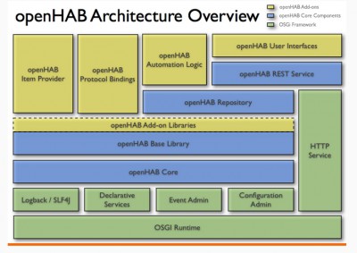

Here I started to play with OpenHAB when I read that Oracle has gone into a bit of the point of sale systems. I wondered why I guess.....

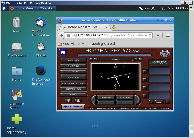

You can also look at xAP Flash.
xAP Flash is a touchscreen based home automation control application written originally for the O2 Joggler. Because it is coded in Flash it can also run on many other devices including Android , Windows mobile, WebOS and also standalone or within most web browsers on a PC . It doesn't however run on the Apple iPhone, iPad or iPod Touch as these devices 'famously' don't support Flash. Apple's Safari web browser on a Mac/PC does work well though.
http://www.automatedhome.co.uk/vbulleti ... lash-forum
Here is a flash based automation application snapshot picture running with Firefox on BuZz's Ubuntu 14.04 build. Earlier attempts to run it on Chrome / FF on the Joggler didn't always work. This application has an integrated CCTV flash piece to it. It works fine with Zoneminder and IP HD cams.
