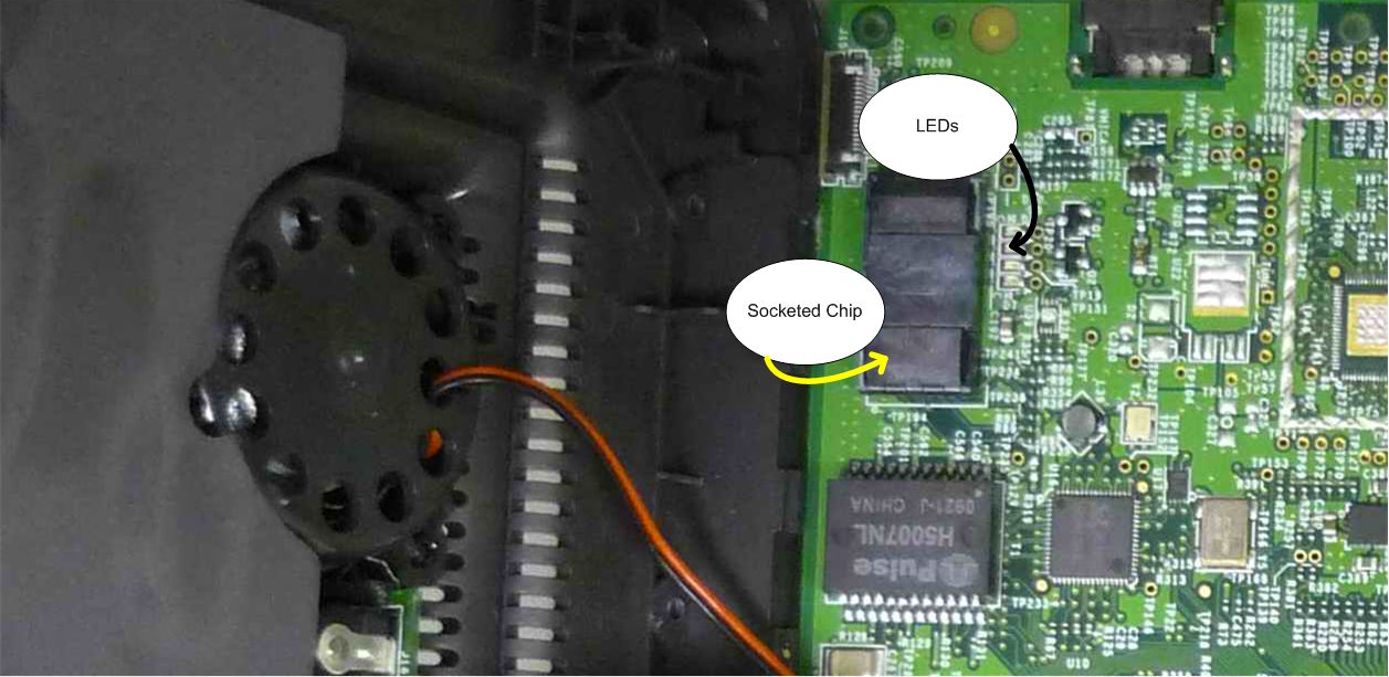

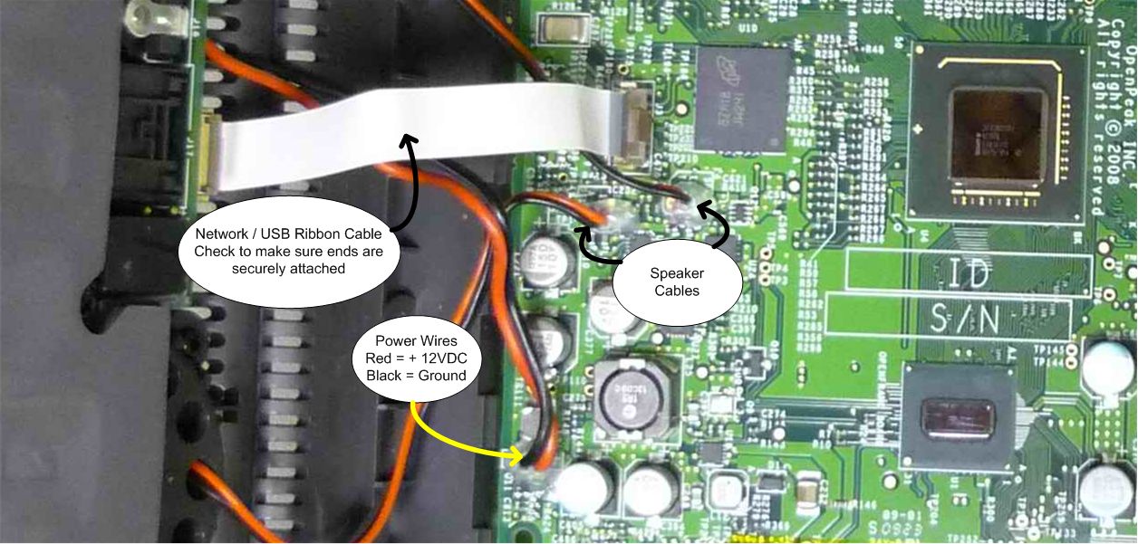

I've removed the screen by unclipping it. I have not taken the sticker off or undone the screws as per the video as I felt that this was unnecessary.
The attached photos show that the screen is indeed connected.
Any other thoughts?

Yeah; push the LCD connectors in anyways. Also push in the connectors you see on the right aux circuit board depicted in your pictures above.
Carefully power it up again while apart (do not let circuit boards touch). See anything?
Next steps.....
If you have a volt meter check the output power of the AC to DC power supply while not plugged in to the Joggler to make sure it is 5VDC.
The center hole is the positive voltage and the outside barrel is the ground.
I have not seen a bad Openpeak power supply yet; but check it anyways.
Remove bottom part depicted in picture from shell and flip it up so you can see the socketed boot ROM chip.
Make sure that the circuit boards do not touch each other while live voltage testing.
Power it up again (be careful!) and watch the little LEDs next to the chip.
The little LEDs next to the socketed chip will flicker when Joggler is booting even if there is no screen connected.
Concurrently look at the screen and see if you see anything.
If the LCD backlights are out you will still see stuff on the screen (it will be difficult to see)
Make sure the circuit boards do not touch each other or any metal touches the circuit boards.
Do the little LEDs next to the socketed chip light up and flicker? If not then the board is dead and not getting any power.
Underneath you will see another little board connected to the main motherboard. It is the USB, Network and Power board. There are two wires for power and a little ribbon cable from the little board to the main Joggler motherboard. Follow the red one to the motherboard. This red cable is the power (5VDC) to the Joggler board.
Look carefully at the little SMDs (surface mount devices) next to the red wire on both sides of the circuit board. See any burn marks?
