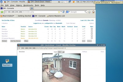

Using Ubuntu 12.10 been testing out various means of live video streaming using Zoneminder, VLC, propietary flash interace and XBMC.
On the XP side you can do similiar. I am streaming to my automation touch clients in Linux and Windows and Android.
You can also do a single stream of SD / HD IP RTSP or MJPG / Live TV streaming with a command line saved in VLC. Works great. I am not sure if I crashed out XBMC just now doing the two below RDP sessions. I have left XBMC running / streaming a live TV view to see if I can break it. I have not.
Running Zoneminder on the Joggler with a couple of IP camera feeds should not be an issue. What is neato about Zoneminder is that it is open and you can create your own interface with it running in the backround. I have done this with a variety of mobile views of Zoneminder which would also work just fine with the Joggler. (ajax and stuff).
Zoneminder will act as a reverse proxy such that you can add numerous cameras and utilize one interface accessing it locally and via the internet. Works way better than opening up your firewall to individual camera feeds.
Today I have two Zoneminder servers set up. One was a hybrid of analog and digital cameras and the other one today is pure IP cameras set up.
Box #1 is Zoneminder set up with an 8 port analog capture card and the Joggler talking Ubuntu 12.10 accessing the ZM box with Firefox. It is also configured with IP SD and HD cameras. The SD IP cameras do mjpg streaming and the HD IP cameras do RTSP streaming. It is configured for 16 cameras; IE: 8 analog and 8 IP.
I have no issues streaming SD video using capture card or older SD IP cameras with Zoneminder and the Joggler.

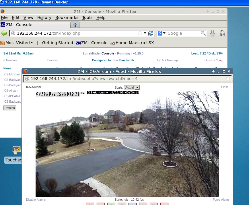

Box #2 is Zoneminder set up only with RTSP IP HD cameras (more than what you see here right now). It is only configured today for Grandstream IP HD cameras. (playing around with using SIP et al on the cameras as its built in). Zoneminder doesn't do SIP yet.
