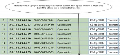

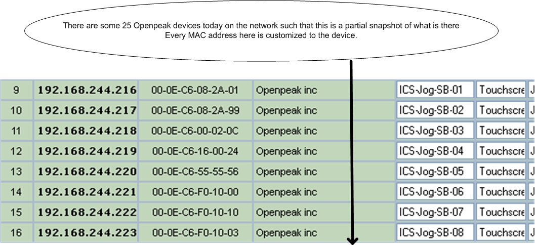

Unrelated specifically to Squeezeplay but more to my network stuff. I am just under 1/2 of a class c subnet here.
That said I utilize a very small scope for DHCP and have my IPs / DNS names and even MAC addresses custom configured.
Reason for this though is that I monitor the network and remote control many devices on the network.
The remote control of each device has to have the DNS name, IP and MAC address validated before the remote control pieces work.
IE: Historically I have also spoofed my mac address on the linux firewalls (and always changing them).
