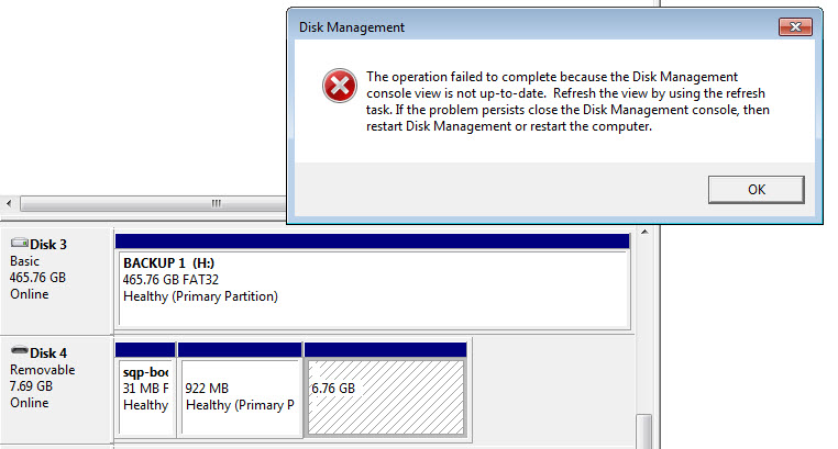

Yes, i write the image, then i created a FAT32 partition using gparted on the remaining space, however when i open in windows, i see the following (upon trying to assign a drive letter)

Re: Smokescreen
Its been a while since I used gparted but do you remember what options you chose when creating the fat partition?
Another alternative could be simply expand the Linux partition, you could then either install Samba to share a folder on the network of use WinSCP to copy your music across. IIRC you were planning on using this Joggler without a connection? In which connecting temporarily and using winscp just for copying files as and when needed.
