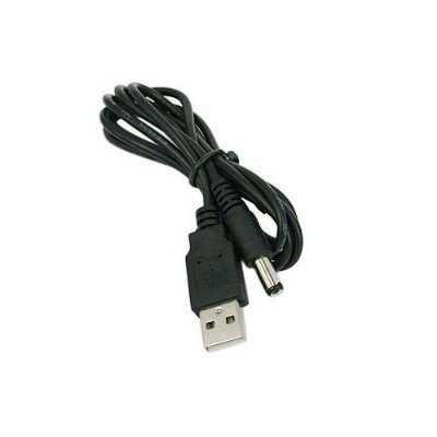

Would these work for powering a car Joggler Pete? or any body with the knowledge?
http://www.amazon.co.uk/gp/aw/d/B008JUXPA0
http://pages.ebay.com/link/?nav=item.vi ... 1356522012
I am thinking the less soldering the better
Re: Car Joggler Project
hawsey wrote:Would these work for powering a car Joggler Pete? or any body with the knowledge?
- uploadfromtaptalk1387323928687.jpg (9.34 KiB) Viewed 5599 times
- uploadfromtaptalk1387323895381.jpg (10.6 KiB) Viewed 5599 times
