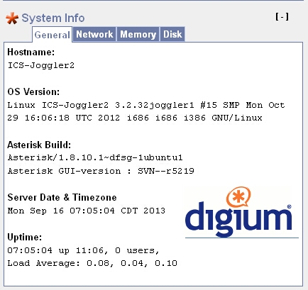

Goofing around a bit yesterday I configured Asterisk on the Joggler II. Works fine; but a bit overkill and may shrink down the PBX to something like PBX on a flash but run it on one of the Joggler II's.

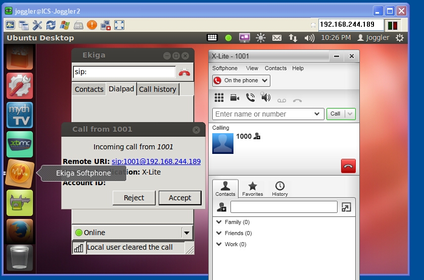

I tried a Joggler 2 to Joggler 2 softphone intercom connection and it works fine. The Ubuntu available soft phones though are not as nice as the Openpeak flash based soft phone interfaces.

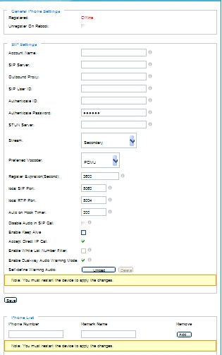

Next trying to see how the new IPHD cameras from Grandstream work as they do have SIP built in. This is kind of leading to a DIY SIP door bell experiment.

Asterisk on the Joggler 2
Generic softphone on the Joggler 2
Grandstream HD IP camera SIP configuration page. This is a test as I have been purchasing and DIYing my IP HD cameras.
