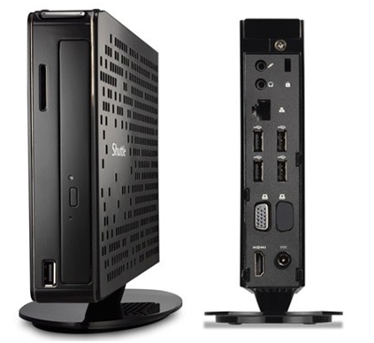

I have my wife set up with a net-top which works for her and is tiny; IE: the size of a large paperback (Shuttle mini pc). She plays some games so she wanted something a bit horsepower. I have a second shuttle in Florida which I utilize and its been on now (along with my wife's) for some 3 plus years 24/7. It does not have a fan and uses a massive heat sink to keep it cool. These do have slim combo drives and either SSD or notebook drives in them.
I found an Asus core duo for $144.00 USD with a 250Gb HD for her. (refurbished). Its bigger than a netop but smaller than a half sized tower.
