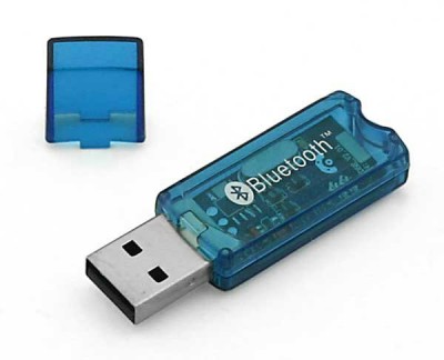

So not wanting to downgrade my phone I tonight tried a Joggler running Android 123 with a one of these Bluetooth usbs
But no good :-/

Ooops pictures are all the wrong way around, will sort out later ,the black poundland Bluetooth was the one that worked, the ObD2 is the bottom picture.

With the Joggler and 1.2.3 Android, no problem (after I had the right Bluetooth adapter in)
