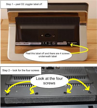

Carefully open up the Joggler with it powered off and unplugged. (I will add a pictorial here).
1 - remove the label on the bottom. You will see 4 screws. Leave the label off. These 4 screws hold the Joggler back cover on.
2 - Look at the four screws on the bottom
3 - Remove the screws. Remember lefty loosey righty tighty. - these screws are just in plastic and you can strip them if you over tighten them. The Joggler case will not fall apart as these screws just hold the bottom part of the case to the front part; but there also are plastic clips which hold the case together.
