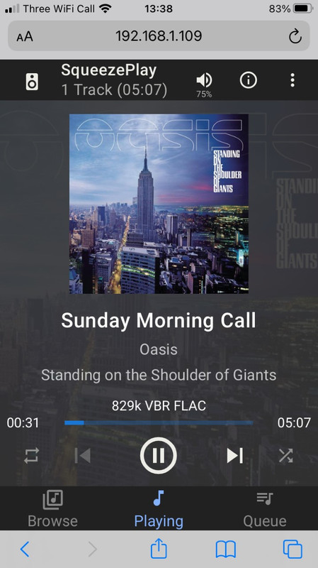

So I have a Joggler with sqpos303 installed and the EDO applet on the internal memory
I do:
sudo sed -i.bak 's/ubuntu.datahop.net/archive.ubuntu.com/g' /etc/apt/sources.list
	sudo apt-get update
sudo apt-get install libio-socket-ssl-perl libnet-libidn-perl libnet-ssleay-perl libcrypt-openssl-rsa-perl lame
	wget http://downloads.slimdevices.com/nightly/8.1/lms/51b8fe3afa8d51a8b8ca07eb580fd7676d7f825e/logitechmediaserver_8.1.2~1617513319_i386.deb
	sudo dpkg -i logitechmediaserver_8.1.2~1617513319_i386.deb
	sudo apt -f install
To LMS I add the following plugins
Material
Music and Artist Information
Radio Paradise
BBC Sounds
Radio France
and the updated HLS:- http://bpa-code.github.io/bpaplugins/re ... ls-v2.xml
All play through the attatched usb dac (Stoner Aqoustics).
This is safari on iphone, Material saved as a desktop shortcut (Tip: after configuring Material, save settings as "Default")
So the Joggler running 7.8.0 should be able to upgrade.
