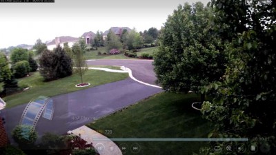

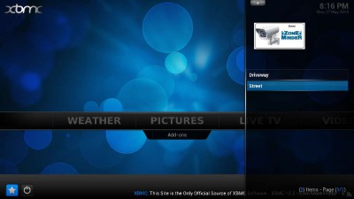

Its just a playlist file which streams live video (720 or 480) from the security DVR (Zoneminder). I have multiple streaming set up with the HD cameras (SD and HD) and the older analog cameras are all SD. IE: streaming live TV works best at SD or 720HD; not really that good at 1080HD (works but a bit jittery).Oooo like your xbmc security set up Pete, how is it set up?
Right now its one playlist file per stream. Each playlist file then is set up to be a "favorite".
Understood about the Joggler/XBMC. I am seeing (for whatever reason) that the Openframe2 devices do a little bit better on streaming video stuff / xbmc than the original Joggler. If Linux though booted off the seabios/coreboot/PATA drive (slow still) you could then use a 16Gb SSD drive inside of the Joggler (I am doing that today with the XP'd Jogglers).
That and the larger Openframe2 with the speakers in the front has a 2Gb MMC card that XBMC fits on.
