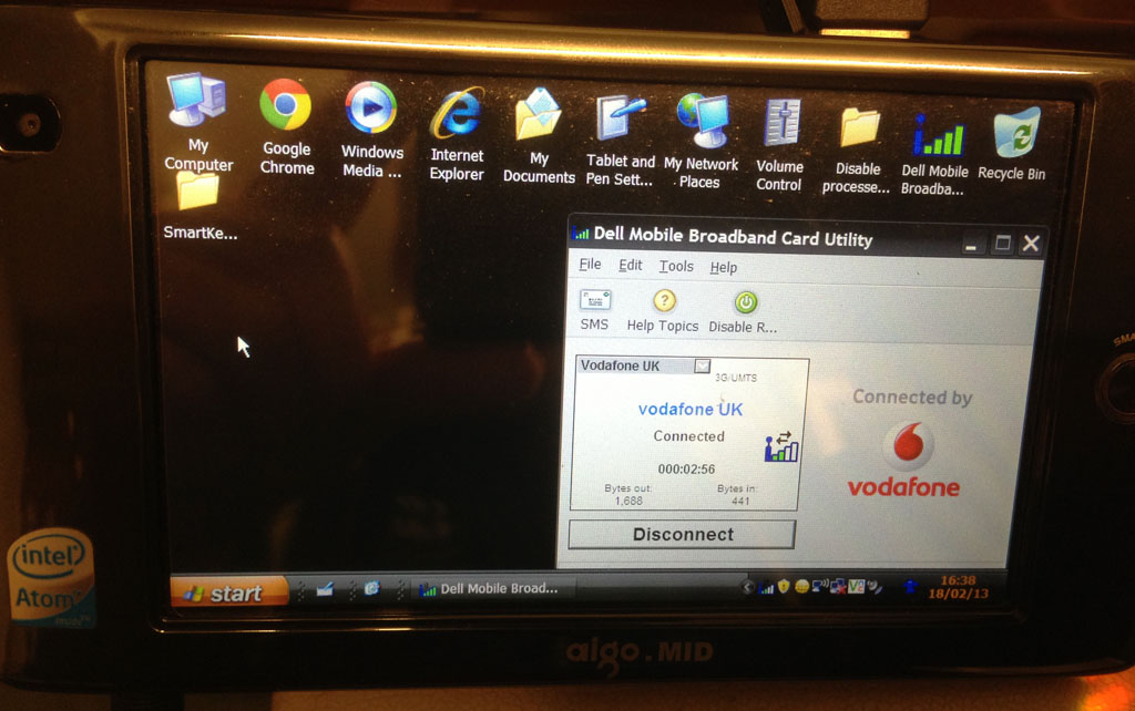

Posts: 409
Yet another use for Mevi's XP, this time on the Aigo Mid. This works very well and I removed USBoot so I don't get the text when starting up
Aigo Mid running Mevi's XP
