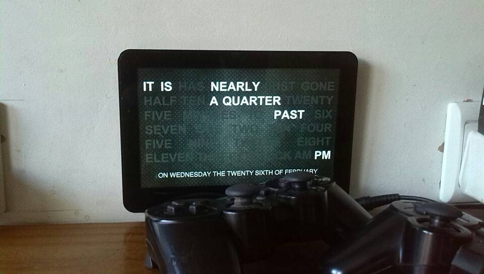

Not sure where to put this.
Just upgraded my Squeezeplay (on SqPOS 1.09) and trying out the new word clock screensaver.
It's quarter past 3 ish and I noticed the attached.
Its not highlighting the hour of three. I'd not actually noticed a problem for earlier hours but hadn't looked that closely.

Just checked on PNP 3 and the same thing. Its just clicked over to 4 and that is displaying correctly so it just appears to be the 3 at the moment.

After some more testing I've confirmed it was just the three not displaying and I've also found and fixed the issue. 8-)
This is on SqPOS so the file locations for other operating systems might be different.
In the file
/opt/squeezeplay/share/jive/applets/WordClock/WordClockApplet.lua
there is a mis typed function where three is spelled with 3 e's
To amend the file type the following at the command prompt
nano /opt/squeezeplay/share/jive/applets/WordClock/WordClockApplet.lua
the press CTRL + W to bring up the search function (AKA where is)
type threee
press enter
delete the extra e and then press CTRL + X to quit
type y and enter
You may need to restart SqueezePlay for the changes to work you may not I'm not sure. I ran the command
killall jive

JimbobVFR400 wrote:After some more testing I've confirmed it was just the three not displaying and I've also found and fixed the issue. 8-)
Thanks for this - I'll tweak the applet in the next SqueezePlay release! :)
