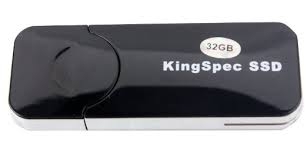

Here and it's been a few years now purchased a few of the Kingspec USB 2.0 SSD sticks.
Way back I did fit these inside of the O2 Joggler removing the wireless stick.
I did go to an external USB wireless stick then. I just soldered on to the motherboard a new USB 2.0 port.
My current Openframe (not O2) Ubuntu box is utilizing the internal MMC to boot a 40 pin ZIF 15cm cable to ZIF PATA SSD. It is so thin that it fits fine over the wireless stick. I did leave the wireless USB stick inside and plugged in. I did glue a small USB 2.0 Hub on the back of the device and wired it USB 2.0 like to the motherboard. Works fine.
I am still using the Kingspec USB 2.0 SSD sticks today and they are fast and work well with Buzz's Ubuntu. Lately been using these to test boot and play with the Openframe 7 devices.
They are difficult to find these days and more expensive than the stock USB 2.0 or new USB 3.0 devices.

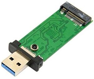

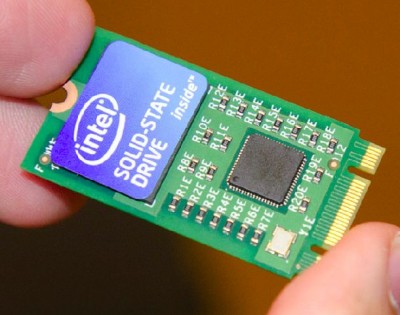

My last computer build I went with an m.2 sata for a hard drive. It is tiny. I am amazed. PC has been on 24/7 now for many months and running well. I noticed now too you can purchase an m2 to USB card. This would fit fine inside of the Joggler.
