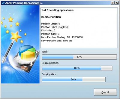

Via Windows try the MiniTool partition manager. I'm trying this right now on a G3 8 Gb memory stick.
You can download the MiniTool partition manager here:
http://www.partitionwizard.com/free-par ... nager.html
1 - copy the image to the 8Gb stick.
2 - Look at the USB stick with MiniTools partition manager; you will see it similiar to above picture.
2 - Expand the NTFS partition to the rest of the 8Gb stick.
2 - Exit out of mini tools and you should only see the FAT partition. Make sure all of the EFI stuff is there.
You can do the same with GParted in Linux.

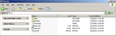

If it still doesn't boot, delete the fat partition and create a new one; then just copy all of the EFI files to it. I've attached a ZIP that has them all.

The boot process is hidden by default on Build 3..... I did that thinking that it's better looking than a screen of scrolling text, but it's a pain in the bum for when things don't go well and we need to troubleshoot.
Unzip these files into the EFI partition and you'll see the whole boot process if it starts at all. If it fails, you'll see where it stops. Sometimes not seeing the active partition will cause the bootloader to stall and then boot the O2 OS. Using a hub and just using a different port to one that you've used before can have the exact same result!
