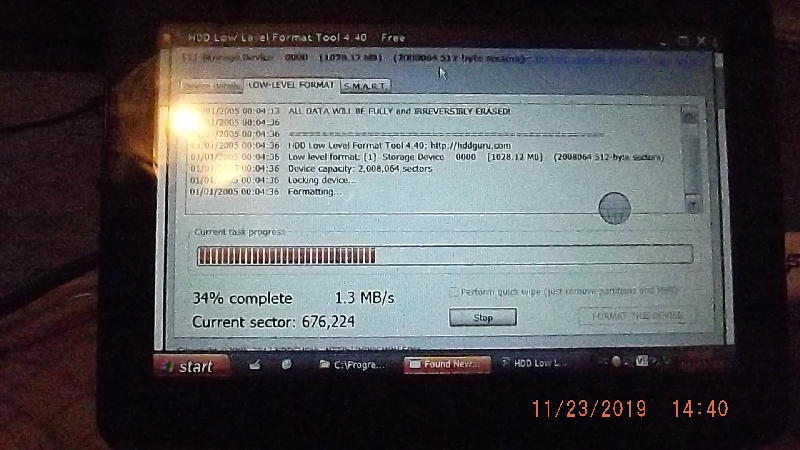

Here tried to do an eMMC low level format under windows. It looks to have worked.
Have not yet done a new base install on the O2 Jogglers. Went off on a bender on the OpenPeak Cisco tablet.
Picked a random O2 Joggler to test new image. Installed OK, reboot saw all sorts of errors and quit booting IE: bad eMMC.
So we have a bad eMMC or going eMMC on the randomly pickd "test" O2 Joggler.
Made up a Mevi XP USB boot stick and copied over the low level formater to the USB stick.
Booted with Mevi EFI XP boot stick and using touch running the Low Level format tool. Looks to be working.
After the above rebooting with new Bionic USB stick to see what happens to eMMC. Not even sure that this will work. Just giving it a try.
Also noticed that this O2 doesn't have a mac address. Never tried to update the MAC ROM via the Mevi's XP USB boot stick...giving it a try...
That did not work in a dos command line prompt. Only other way is to write the seabios rom first then boot with a dos USB stick.
OK looks like it may have fixed the Joggler O2 eMMC as the new write of the internal OS went really fast. (check disk part).
Well it looks like using the Realtek rom write in XP dos wrote over the EFI boot rom. Doesn't boot anything (internal or USB). So I bricked it. Before doing a flash chip swap will try the blind typing thing.
