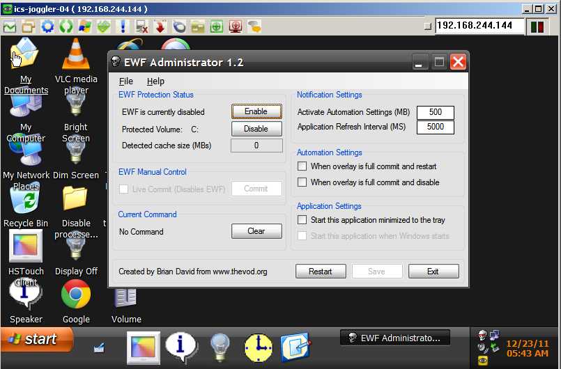

Will install the GUI's. Thanks Dan.
I just remotely was able to VNC and disable both EWF; shut them down. Will restart them both and install the EWF GUI's.

definately sounds like ram, try the limiter on the gui, set it to 128mb and see what happens, that will let the ewf fill 128mb ram, then commit and disable, then re enable the ewf without any cmd involved lol

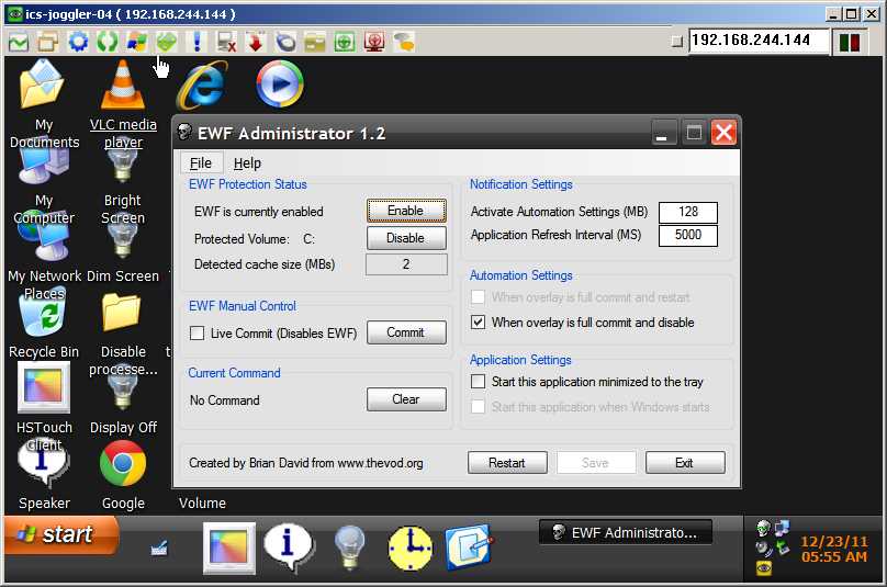

Where do I set it to 128 Mb? In the Detected cahce size?

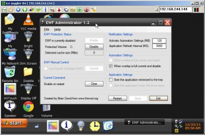

The second picture is what I did. Then rebooted it.

Yeah, That where i would do it, also tick when overlay full commit and disable
As i said have not used this, but looking at the pictures what you did seems right lol

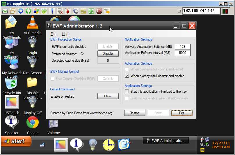

Yes, did that. First and second pictures are out of order above. Rebooted and here's another view.

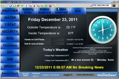

Enabled the networked HSTouch application. Doing much more now (more networked stuff) relating to the transport.
All the variables you see on the screen is some chatter between the Joggler and the mothership being updated dynamically.
