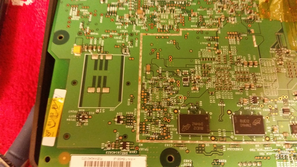

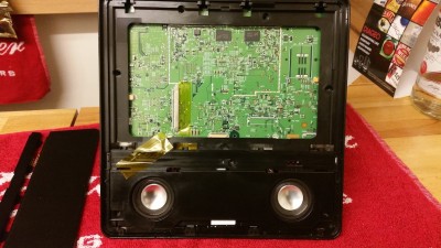

Pete
Have got the screen off my OP 2 and removed 7 screws.
how do I get to the board, surround still seems to be fixed.
OK found the other screw under the white paper, finally got it apart.
Noticed it has a place for a sim card as well as the sd card.

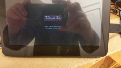

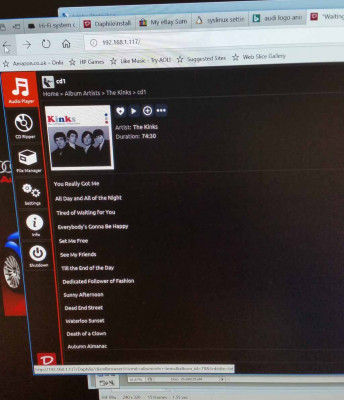

I have Daphile booting on the EFI Joggler, I used a 16gb SSD stick and copied the contents of the iso to it.
I then used these files (attached) copied to the root of the stick. I could only get it to work connected to Ethernet.
After booting connect through a browser using the address displayed on the joggler screen.
After shutdown from the settings on your browser screen, remove the stick and put some music in the music folder.
You can then restart & play the music through the joggler from a browser on any other pc, phone etc
