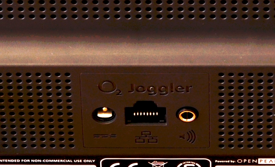

Is your seabio'd Joggler an O2 Joggler or an Openpeak device?
What is the embedded on plastic name? O2 or Openpeak?
