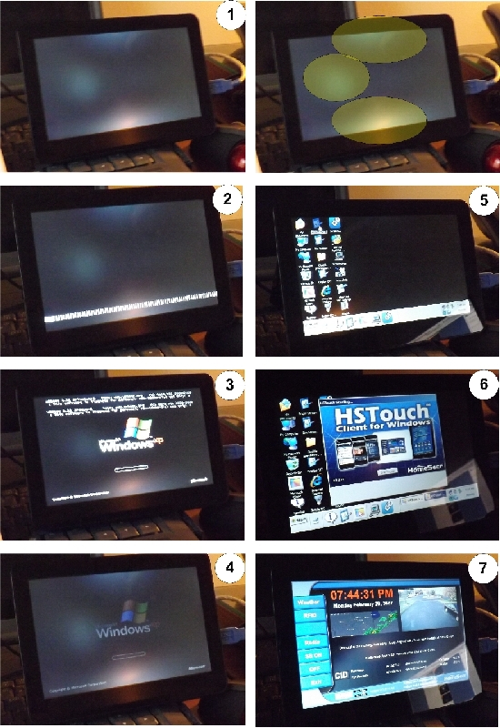

I'm using one of the Jogglers with mostly the internal NIC card not booting up (test one) so right now testing with an external USB device.
The above noted though switched over to using the Digi 7 port powered USB. Works much better even though its only USB 1.X. I can image the SSD drive over to an externally mounted via USB ZIF SSD. Works fine.

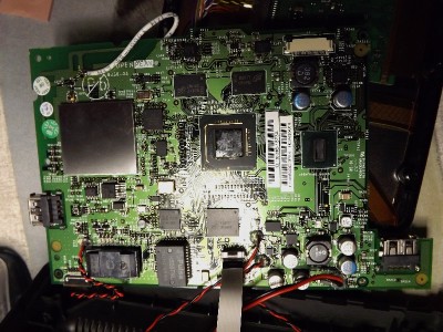

I know what you've got there. It's a Joggler with a full OpenFrame 1 board. That's a rarity!pete_c wrote:Whoa; amazed here today.
I just opened up a new (refurbished) Joggler (officially now the count is at 12 here of these amazing little boxes). It's modded exactly like the previously purchased Joggler. Already has the PATA port and all.
Just getting ready to update the flash to the most recent version of Seabios. I am curious about the NIC card on this one.
Curious cuz the last one appears to have two sound cards in it? It has a "Vega" driver plus the stock audio driver. Anyone ever see this?
Basically, the Joggler has no DECT hardware (not required by O2, so not normally populated on the board). Yours would seem to have a full board; the Philips VegaOne will be the audio interface to chat to the DECT phone. As far as I knew only the Telefonica Orby had that. Perhaps they've been using Orby boards to repair Jogglers? Makes sense as they're both off sale now.
BTW, if anyone ever finds a Telefonica Orby and the matching phones, I would be very interested in having them!

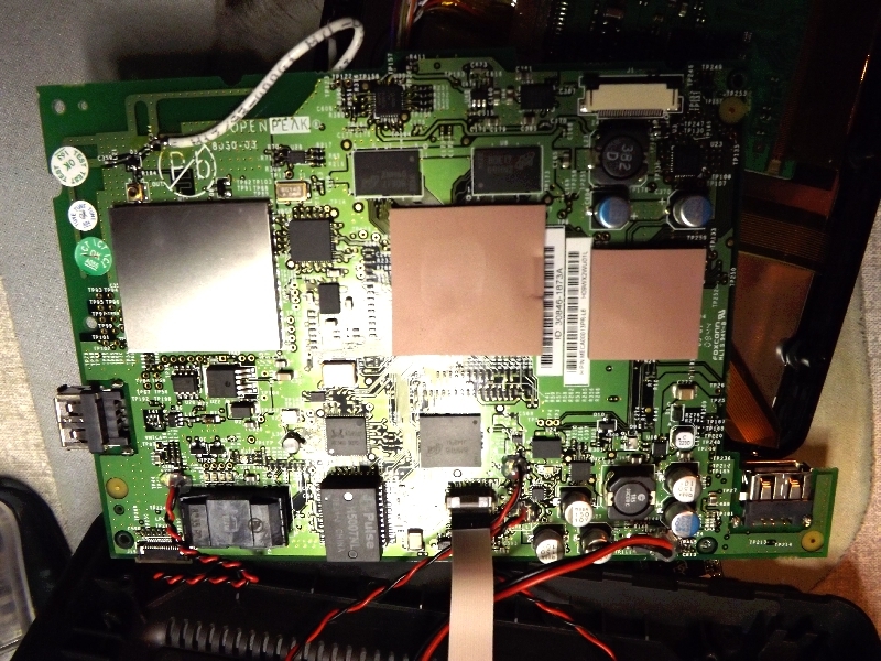

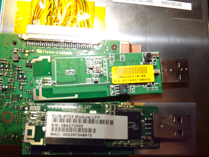

OK so I have decided that the two newest Jogglers are "keepers". These are using one large metal heatsink mounted in the same fashion as O2 Openpeak Jogglers. The wireless USB stick provided; without the wired antennas; has the antenna integrated into the stick itself as traces with no mini wireless terminals on it. I have taken some pictures of the motherboard and inside of the OpenPeak "refurbished" Joggler and will attach the pictures to this post.
Re: Coreboot and SeaBIOS
those metal shims on the atom and GMA and the big heatsink are new for me - not seen those before. Good stuff!
Those are rubberized and they sit against the metal heatsink. Once side of the metal heatsink has small fins on it. I haven't checked to see how this one runs XP and whether the NIC works well in it. The other one has been SeaBios'd. That said it looks to be that Seabios itself will not work so far with the NIC. Do you have any seabios'd Jogglers with a working XP NIC Mevi?

That silver square on the board is the DECT hardware which is unpopulated on the Joggler.
