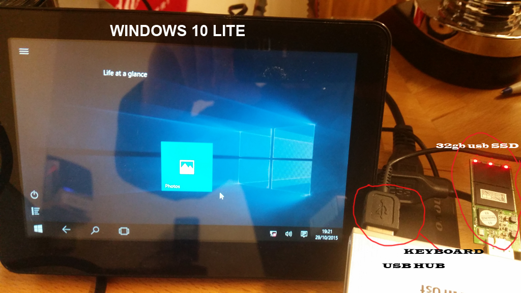

Hi everyone
Not been on for a while but now that I have retired I have more time, after seeing that Pete had Win 10 working off the pata port I thought I would have ago at USB (still with SeaBios)
I used a 32gb USB SSD stick and WIN7toUSB along with win10 lite from sourceforge, it was reasonably straight forward. Also I have rebooted a number of times and its still working.

Very nice Mickchip!
Happy New Year!
Is that a kingspec USB 32 gb SSD stick?

You don't actually install it to the USB stick, It actually installs itself from the USB stick
You need to unrar the folder on to drive C:\ or any ware else, have the Windows 10 iso mounted so you can see the files & folders
mainly install.wim & boot.wim
Go into the folder win7usb and double click the file "INSTALLER.cmd" and just follow the prompts.
It takes a long time to transfer the install an hour or more but once its finished remove the stick, put it in your SeaBiosed Joggler
and it will boot and install.
Hope you can understand this.

Re: win10 on Joggler
Here you go
1. Download the attachment win7usb.rar, unzip to drive c: on your PC, you should then have a folder "win7usb" on your PC.
2. You should have a windows 10 iso on your PC. I used Win10_1511_English_x32.iso, double click the iso file which will mount the file as a DVD with a drive letter. ie Drive E:
3. Insert the USB stick or USB hard disk in your PC and note the drive letter assigned, ie Dive F:
4. Note the drive letters of the Win10 DVD & your USB stick/Hard drive
5. Open the folder win7usb on your PC and double click the file INSTALLER.cmd
6. Follow the instructions in the program, this will create the Windows 10 USB stick/drive. (It takes a while, just be patient)
7. When finished, if you want to make it a lite version as I did. Download the attachment "WinLite10V5.1.rar" and unrar/unzip to the root of the USB stick/drive, this will give you a folder "Winlite10v5.1" on the stick/drive.
8. Remove the USB stick/drive form your PC and boot the joggler with it.
9.When Windows Setup ask you for input, enter nothing for now!!!
10. Now press Shift+F10 on your keyboard. A command promt should open.
Type "cd \winlite10v5.1" and press enter
then type "rmApps.cmd" and press enter, and answer the questions for your needs.
11. Close the command promt and finish Windows 10 Setup.
