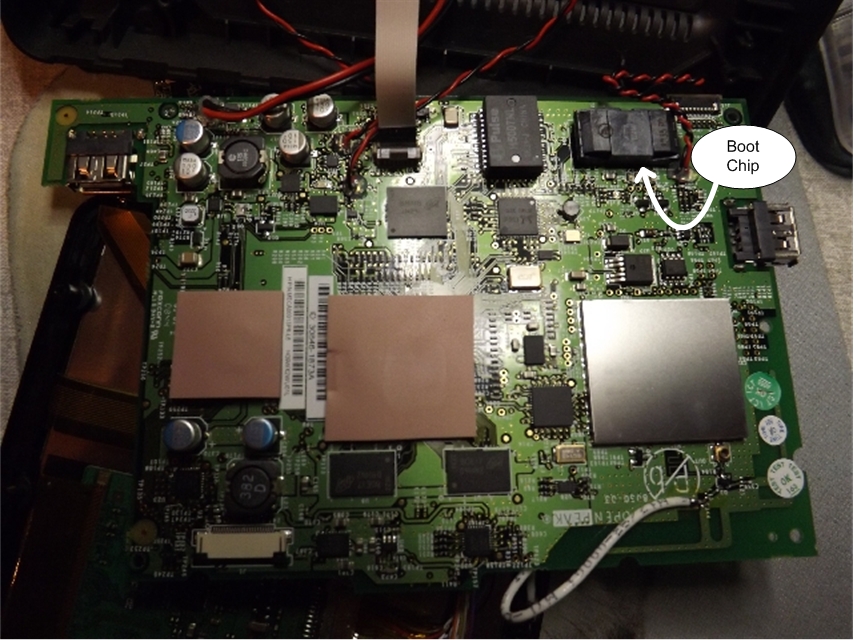

One other thing you can do if you have more than one Joggler is the hotswap of the boot chip. It's easy but looks a bit scary.
1 - open up your Joggler - make sure the Joggler is not plugged in to any power source as you test this.
2 - remove the screws that hold the motherboard in place
3 - look at the enclosed boot chip socket on the top of the motherboard and to the right on the side of the motherboard that faces the back of the O2.
4 - practice opening the cover of the boot chip socket
5 - practice removing the boot chip and putting back in place
6 - now open the problematic Joggler - leave them both open so you can see its guts. Mark the problematic one with a piece of tape.
7 - while open remove the boot chip from the non booting Joggler
8 - start up the good joggler with it open (with a network cable plugged in to it).
9 - SSH to the good Joggler
10 - remove the good boot chip from the good Joggler while it is on. (be careful)
11 - put the non booting chip in to the boot socket of the working Joggler
12 - write a new boot flash to the boot chip
13 - remove the chip and replace it with the original booting chip
14 - put the old chip back in to the non booting Joggler
15 - power it on and see if it boots.
Thinking too the flash rewrite also writes over the boot flash but if you cannot boot in to it; it will not work.
