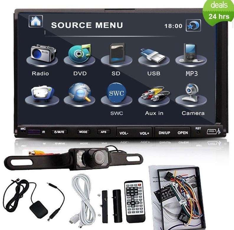

Re: Strange Flirc behaviour
Went looking on Ebay for a DIN mounted HU with some stuff on it and found one for around $100 USD. Just a couple of years ago these were $300 USD.
I noticed a bunch of CE or Android based HU's. I have modded tablets and put CE or LInux on them and they run fine.
The Joggler does look nicer though.

pete wrote:Went looking on Ebay for a DIN mounted HU with some stuff on it and found one for around $100 USD. Just a couple of years ago these were $300 USD.
No optical out though,the point of the Joggler amongst other things is it's the cheapest possible way to get an optical output.Cheapest optical output car headunit £1000 or more for a Pioneer ODR or Alpine F#1 Status,my current Joggler just £37 for the same quality.
