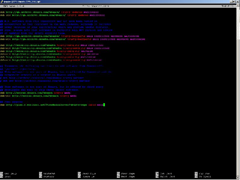

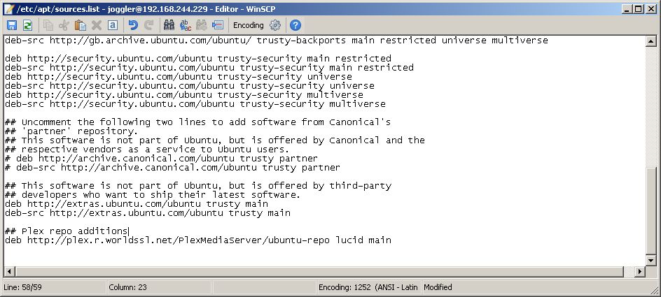

I looked at this way to install PMS but didn't quite understand the first bit about adding to your /etc/apt/sources list file [URL[/URL] , do you just type it in and hit enter like the other commands ?
So because I was unsure I am giving the instructions for the desktop a try first .
Re: Plex Media Server on the joggler
Hawsey,
Try with WinSCP for Wintel.
http://winscp.net/eng/index.php?#utm_source=winscp&utm_medium=app&utm_campaign=5.5.3

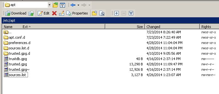

1 - Go to the subdirectory /etc/apt
2 - click on the /etc/sources.list file to edit
3 - or with SSH just:
login as: joggler
joggler@192.168.244.229's password:
Welcome to Ubuntu 14.04.1 LTS (GNU/Linux 3.2.58joggler1 i686)
 * Documentation:  https://help.ubuntu.com/
1 package can be updated.
1 update is a security update.
Last login: Mon Jul 28 15:58:03 2014 from 192.168.244.230
joggler@ICS-Ubuntu-229:~$ cd /etc/apt
joggler@ICS-Ubuntu-229:/etc/apt$ ls
apt.conf.d  preferences.d  sources.list  sources.list.d  trustdb.gpg  trusted.gpg  trusted.gpg~  trusted.gpg.d
joggler@ICS-Ubuntu-229:/etc/apt$ sudo su
joggler@ICS-Ubuntu-229:/etc/apt$ nano sources.list
root@ICS-Ubuntu-229:/etc/apt#
4 - in your SSH terminal connection then:
cd ~/
$ wget http://plexapp.com/plex_pub_key.pub
$ sudo apt-key add plex_pub_key.pub
$ rm plex_pub_key.pub
5 - then while still in your SSH terminal connection type:
$ sudo apt-get update
$ sudo apt-get install plexmediaserver

Yes.
Easiest to just install Putty from here on your wintel desktop first and use SSH to download and install Plex.
Its way easier to do this via SSH.
You can do it on the Joggler too if you have a terminal session open. Just do a sudo su before you edit and install Plex.
That said easy also to do this remotely with a windows RDP session to the Joggler.
BTW to install windows RDP on the Joggler just do:
1 - ssh to the Joggler
2 - sudo su
3 - apt-get install xrdp
4 - go to your wintel PC and RDP to the Joggler using joggler / joggler to log in.

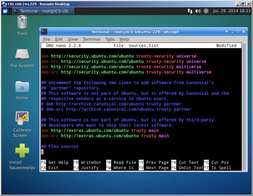

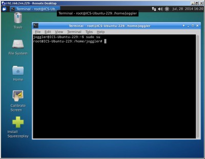

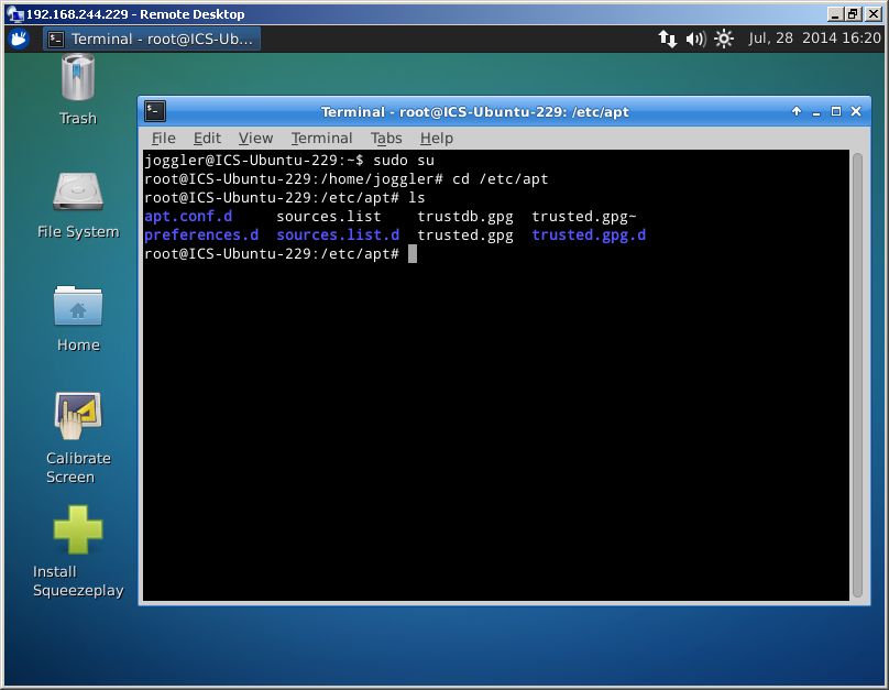

Here are some images from an RDP session from a Wintel PC to the Joggler.
Once it is installed it will run by itself and should autostart on reboot. Then just go to the browser and make your changes to it.
http://www.chiark.greenend.org.uk/~sgtatham/putty/download.html
1 - Click on Putty to open it
2 - put in the host name of the Joggler on the top
3 - put in the host name in the saved sessions box and save
4 - click on the open box on the bottom
5 - type in your name and password (joggler and joggler)
6 - do a sudo su
7 - then cd to /etc/apt
8 - do an "ls" to make sure you are in the apt directory

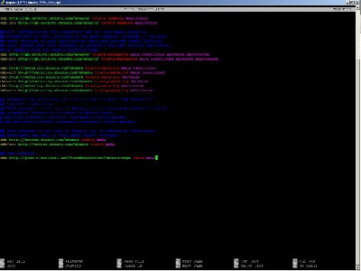

9 - then type nano sources.list
10 - cursor down to the bottom of the file
11 - put your stuff there
12 - hit control x and save file
13 - continue with the rest above
