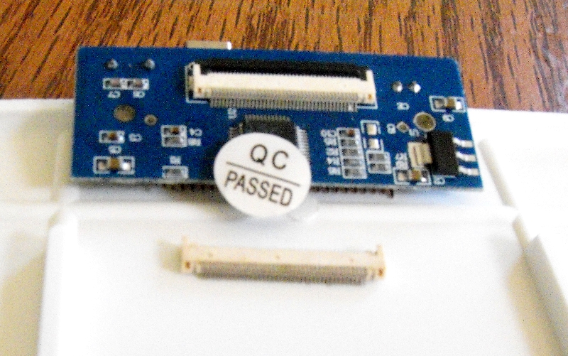

Today will attempt the baking thing to extract a ZIF connector. Attached is a before picture. Pre-heating oven to 500 degrees F. Oven heated up in about 15 minutes. Using kitchen table today. (concurrently doing electrical and the Joggler is my relaxing between electrical work).
Using a small plate with a piece of aluminum foil on it. Set timer to 10 minutes and using tweezers to remove zif connector from board.
Worked on test board. 10 minutes at 500F. I desoldered second one with little clip on it. Worked great.

Am baffled by this truly mad melting method. How is it that things aren't heat damaged?pete_c wrote:Been doing some electrical work around the house in the last week or so.
Re: Coreboot and SeaBIOS
How do you think they get the connector on there? With a soldering iron?ilovemyjoggler wrote:Am baffled by this truly mad melting method. How is it that things aren't heat damaged?
All electronic components have to be able to withstand temperatures of 300+ C for at least 45 seconds or so, as that's what they do at the factory, stick the whole thing in an oven!
Components such as the ZIF connector, being made of plastic and all, are especially delicate during wave soldering. Careful!

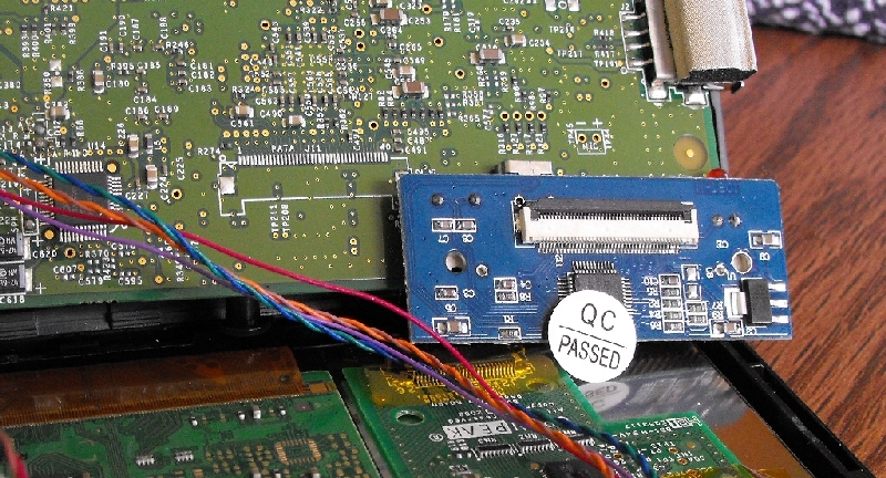

Next step is soldering the ZIF connector to the Joggler main board. Easiest here to remove the board cabling; for me at least.
I am very neat and will leave the kitchen exactly the way it looked before I did anything.

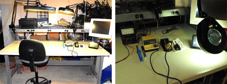

You guys have convinced me to set up my old electronics workbench. (its been in storage in the basement and not really used in the last 10 years).
It would be a PITA to try to solder the Joggler PATA port on the kitchen table.

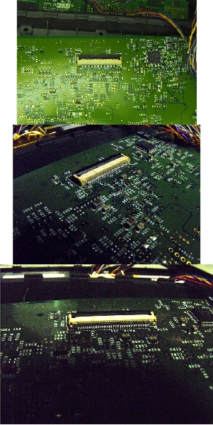

Easy and 10 minutes. I covered all of the solder pads with flux (IE: couldn't find a flux pen; so just utilized a toothpic to apply the flux). The side pads only had a little bit of the solder pad showing making it a bit difficult. Before soldering I used a straight end ruler to bend the 40 pins down a bit such that a side view showed them a bit below the connector. I held the connector down with one finger while I soldered one side pad; then the other. I applied more flux to the 40 zif pins and barely touched them with the soldering iron and the pins instantly connected. I validated the connections looking at the board from the side where you can see that they are all connected. Next will connect a ZIF SSD drive. I made a bigger deal out of this than it was.

Thank you Mevi; it was the flux that made it a simple task. Also using my old workbench rather than the kitchen table was a bit easier.
Ordered a small 1.8" 16Gb SSD/ZIF drive for $25 USD a few minutes ago.
