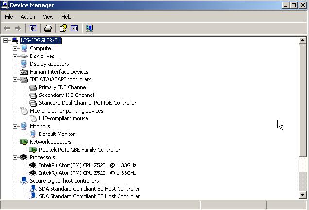

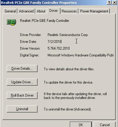

Its very hit or miss getting it to boot with the internal NIC. It remains an issue to be resolved.
I have the WLAN card removed on one of the Jogglers. My preference will be to run the Joggler with the Internal USB SSD card and no wireless.
I've attached pictures showing version of NIC driver. I started to play though with unplugging and plugging in the NIC; way too much of a manual effort. Try cold booting it a couple of times without the cable plugged in. See if the driver loads. After the driver loads and you are in the desktop GUI try then to plug the cable; it'll either lock up or get a DHCP address. If it locks up try it again from a cold boot. I'm currently testing one Joggler connected to a Gb switch. I do though have three Jogglers online via their internal NICs; been on now 24/7 for the last week or so.
